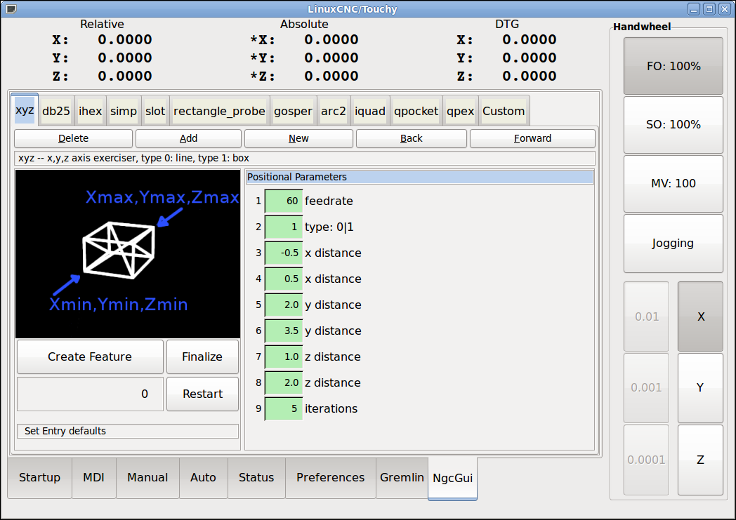

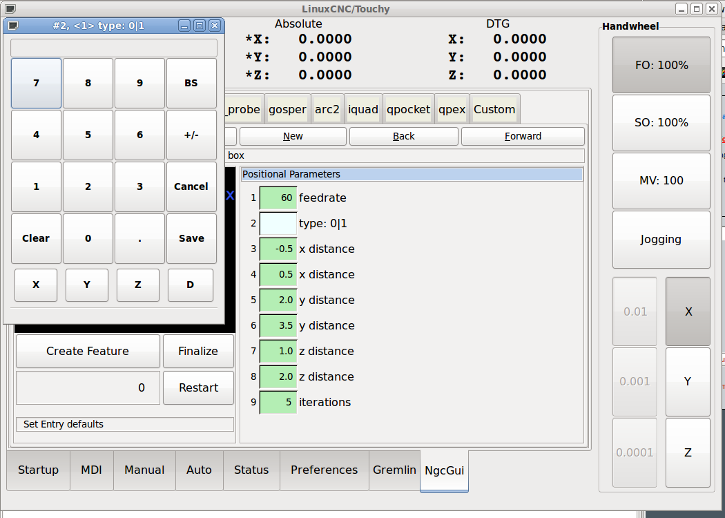

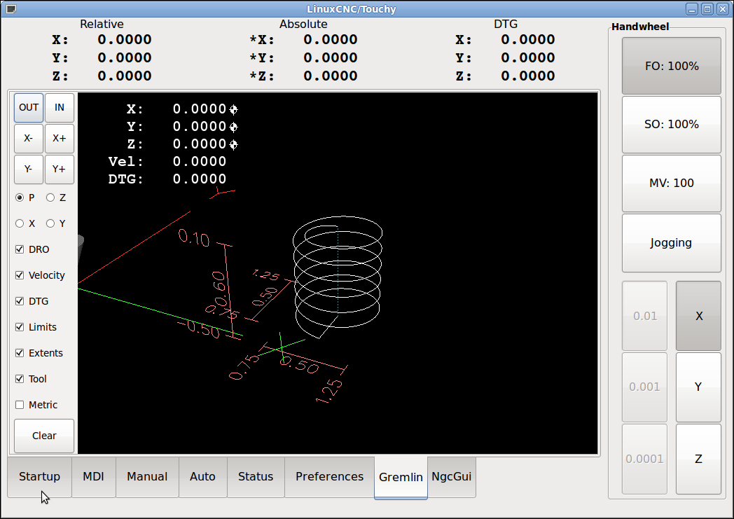

Touchy meets ngcgui and gremlin was created by BigJohnT
Dewey has been doing work on pyngcgui a python based ngcgui for LinuxCNC and has added it and gremlin as options to touchy. The work is based on the 2.5 branch and a patch must be applied to test/use it. I've been using it on my BP knee mill with a touch screen and it is much better than trying to use Axis on a touch screen. I find it fully functional if not a bit anally programmed to take you out of jog mode for anything you do. While I know Touchy, Gremlin, and Ngcgui are not a good fit for a production shop that runs millions of parts for one off work they are essential and speed up the work flow.

Dewey is looking for testers if anyone is inclined to do so.
Open a terminal and issue the following commands.
If you don't have git installed on your computer
Create a checkout and build linuxcnc
Add the patch and build linuxcnc
Run LinuxCNC and pick a sim from ngcgui to run
To install a new patch from the cnc-dev directory
sudo apt-get install git-core
git clone git://git.linuxcnc.org/git/linuxcnc.git cnc-dev
cd cnc-dev
git branch --track v2.5_branch origin/v2.5_branch
cd src
./autogen.sh
./configure --enable-run-in-place
make
sudo make setuid
cd ..
. ./scripts/rip-environment
wget http://www.panix.com/~dgarrett/pyngcgui/pyngcgui.patch
git am pyngcgui.patch
git log -1 --oneline
cd src
make
sudo make setuid
linuxcnc
rm pyngcgui.patch
git reset --hard origin/v2.5_branch
cd src
make
sudo make setuid
cd ..

by BigJohnT
Replied by BigJohnT on topic Touchy meets ngcgui and gremlin
The gremlin backplot will show any axis you have defined in the ini file... I don't know about jog buttons. Give it a twirl and see.
