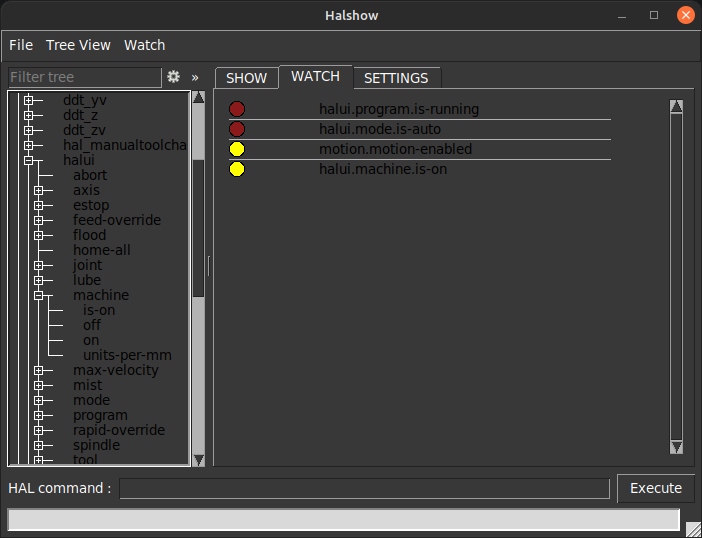

I need to reset the motion.digital-out-00 signal when the emergency button is pressed.
once activated with M64P0 if I have an emergency and I press the emergency button it remains active, it is not affected by the situation
I managed in classicladder to turn off the physical pin where I have the signal connected. But the dout-00 signal remains active and when I turn on the machine with F2 the dout-00 signal turns the physical pin back on.
How can i fix this?
try to create an M104-M105 command to see if they reset but it's the same.
How can i fix this?

Use one of those pins through an AND component, motion.digital-out-00 to one input, Any of the above to second input, output to output pin.

I think that tommylight's approach is probably the safest. Except that the signal will then turn on when you start the machine again, which you might not want.
You can try adding a reset command to the "on abort" section in the INI.
linuxcnc.org/docs/stable/html/config/ini...l#gcode:ini-features
I am not 100% sure that that runs on e-stop though.

You don't need to be a programmer to configure the and2 components in HAL, and I would suggest that approach as a starting point.
Then I would experiment to see if LinuxCNC calls the ON_ABORT_COMMAND on e-stop. Maybe just a simple telltale likeThat should certainly trigger if you press "Esc" during a G-code run. I am not sure if it runs on e-stop.
ON_ABORT_COMMAND = (DEBUG, this is on-abort-command)Please Log in or Create an account to join the conversation.
