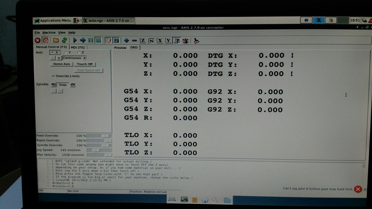

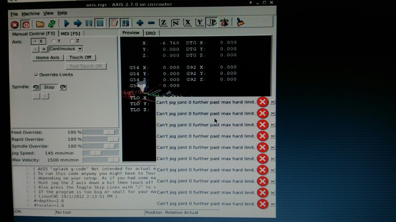

I tried to connect limit switches in parallel, so they could all work as one but after I had connected everything and tested I bumped into a problem I haven't managed to find solution for.
The problem is that when the router bumps into one of the switches it throws an error saying "can't jog joint 0 further past max hard limit". I've googled some pages with similar problems but to no avail so far.

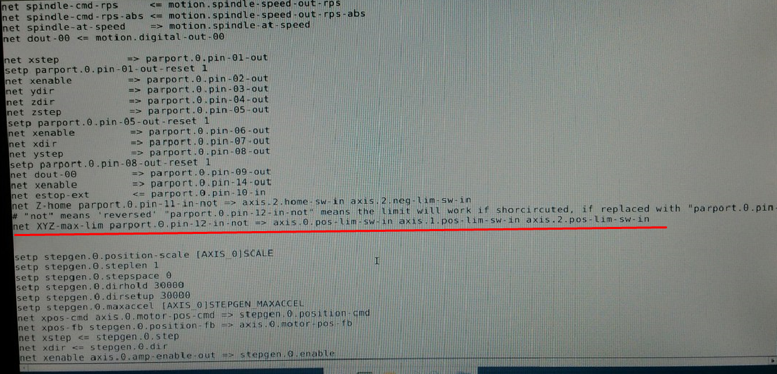

The switches are connected in my .hal file like so:

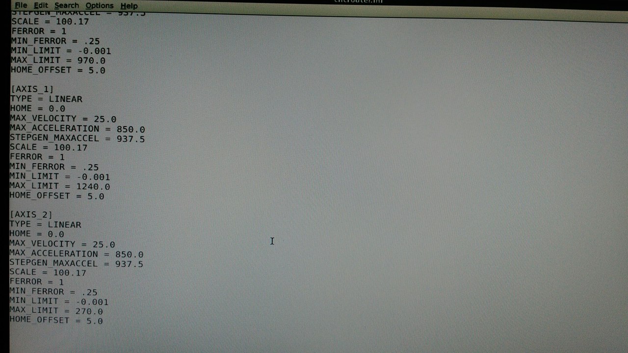

I've also attached the picture of .INI file of my router config (sorry, I wasn't able to get the file itself for there were some problems with copying it to a flashcard).
What am I doing wrong? Is there a way to change this behavior?
Code:
net XYZ-max-lim parport.0.pin-12-in-not => axis.0.pos-lim-sw-in axis.1.pos-lim-sw-in axis.2.pos-lim-sw-in

I believe you'll need the switches in series to get what you want. Depending on your trigger logic you'll have a loop that pulls the homing pin high or low when any of the switches either breaks or completes the loop. Since you're using a "not" pin, that would imply you'll need to create a wiring loop that is normally closed and pulls the pin high until any of the switches is opened by axis travel limit contact.

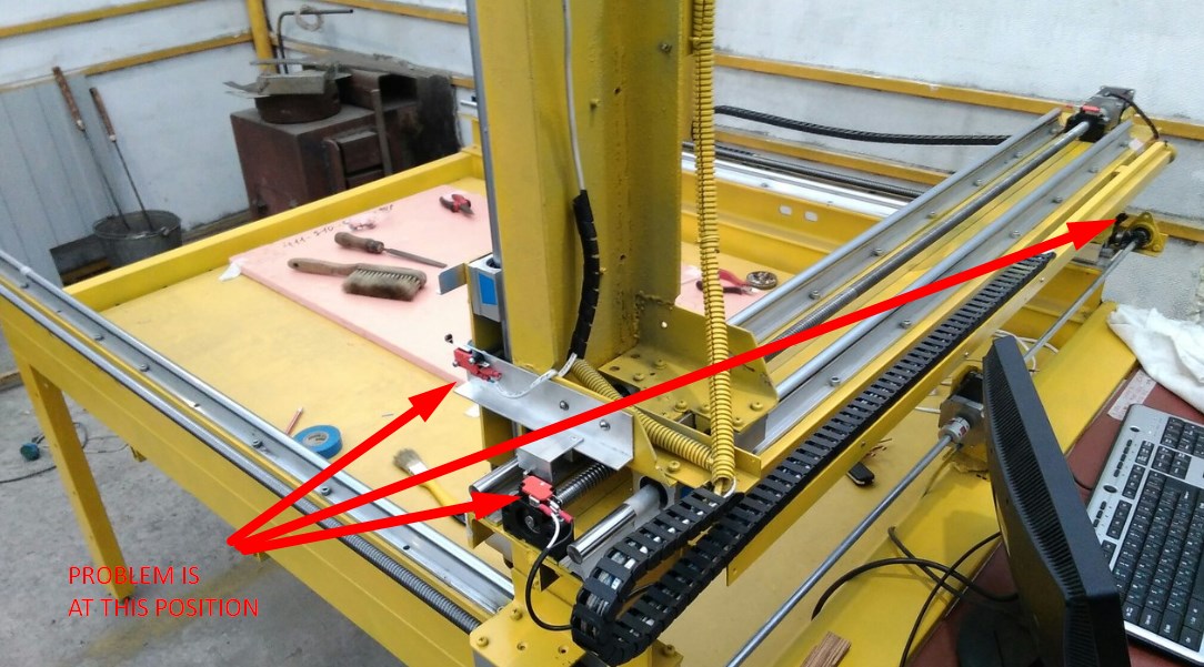

I can't provide a separate pin for each switch because I only have 4 of them on my board, and one of them is used for a tool touch-off plate. But in this case it wouldn't even change anything whether I connect 3 axes separately or just as one switch. The router would just get stuck every time it reaches 0:0:0 position on any axis. I believe there must be some programmatic solution to this.
All I want is the router to stop when it bumps into any of the switches and then be able to jog it back again by checking "override limits" box. At the moment I can only do it if it hits any switch on the other side of the router frame
What does this "hard limit" mean? And why does it need it at all?

The problem appears to be your soft limits. A home offset of "5" says your home switch is 5mm from the end of physical travel. If you were using separate limit switches you'd have a distinct limit switch at physical "0" and you'd leave that "lost" 5mm as safety margin. That 5mm point would be measured as the point where your homing cycle completed its latch back-off. So if you're approaching the limit switch from the positive end of the axis, latch velocity is a negative number, it would find the homing switch and move to home -- with in this case is also toward the negative end at zero. As you're configured now, you're instructing the axis to go backward to zero from home offset after finding the switch. Since it can't get to zero without tripping the switch, you're caught in trap.

p.s. It was not my setup, most of this is the default configuration of linuxcnc, including the homing offset of 5 (I didn't even know what it meant until you told me)
Replied by caseyryan on topic Parallel limit switch connection problem
So, how can I resolve this? Change the homing offset to some negative value, like, say -10?you're instructing the axis to go backward to zero from home offset after finding the switch
