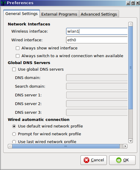

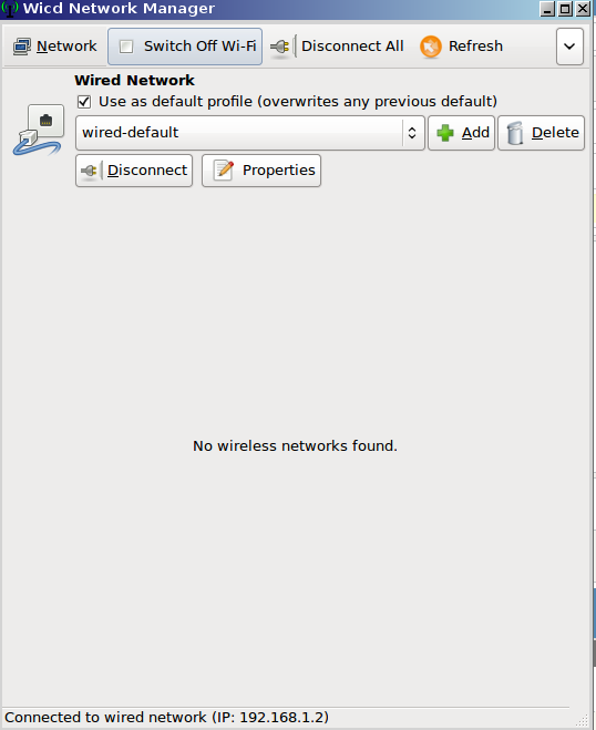

Now you can open up wicd and click on the right hand drop menu [V]
Select 'Preferences', get this menu and add your WLAN desigination, in this case wlan1.

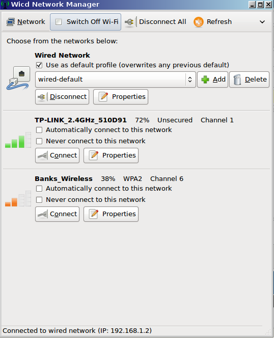

Then click OK and return to main dialog and click [Refresh], after which those stations you detected should come up and you are up and running once you select one of them and sort out password etc.
Note the strength of first station is 72%
That was 3ft from the router! Just shows how flaky these dongles are, my laptop gets 100% anywhere in visible range and 85% 15 metres away, behind 3 brick walls.
