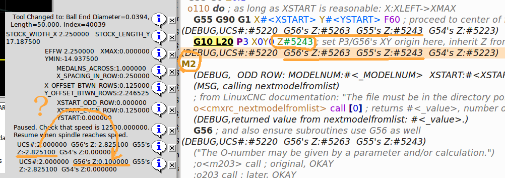

I'm making copies of an object by using G55 to move to a new center point and then setting G56's X0Y0 origin to that point to cut it out.
I have had a couple of close calls when I inevitably forgot to set G56's Z identical to G55's Z before starting the program.
So, I got the bright idea to do it in the same G10 L20 P3 statement I use to reset G56's origin; this way,
G10 L20 P3 X0Y0 Z#5243
with reference to this section in the G-code Overview.
Then however, I did something unusual for me: I tried to verify that it did what I thought it would.
Looking at the output of the two DEBUG statements, the G10 L20 did not change G56's Z to G55's Z, although it changed to something else. (Note the M2/stop after the second DEBUG kills the program during the first iteration of the do-loop.)
Can someone explain what I'm doing wrong?
[Also, I'm merely curious about the "gaps" between the Numbered Parameters; e.g., between the G54's #5221-#5230 and the beginning of G55's, which starts at #5241. Are those parameters reserved for future expansion (more axes possibly) or do they have current use?]
Thank you.
Thank you.

"Could it be that, for example,"
The Numbered Parameter #5243 refers, NOT to the current value of Z in UCS G55, BUT to the current value of the Z-offset (from G53/absolute/machine's origin) to the Z=0 origin in UCS G55?
I would like to know how to reset the value of G56's Z-coordinate to the current value of G55's.
Thank you.
Thank you.

This seems to be the answer, from the
same section
in G-code Overview noted above:
#5422 appears to refer to "the current value of Z in the current user-coordinate system."
This snippet works to set G56's current value of Z to G55's:
* 5420-5428 - Current relative position in the active coordinate system including all offsets and in the current program units for X, Y, Z, A, B, C, U, V & W, volatile.
G56
(DEBUG, UCS:#5220 3=>G56::Z:#5422)
G55
(DEBUG, UCS:#5220 2=>G55::Z:#5422)
G10 L20 P3 #5422
G56

You can also (maybe) use the named parameter #<_Z>
