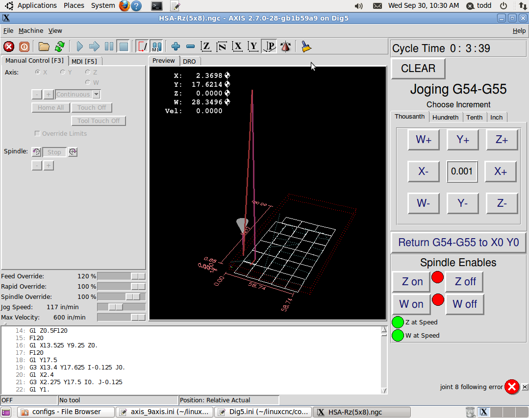

I need a button "go to home" , processing speed indicator and processing time indicator

12 Sep 2018 13:44 - 12 Sep 2018 13:48 #117397
Replied by Todd Zuercher on topic Adding custom buttons
I use the standard Axis user interface on the routers I've retrofitted and by adding an additional VCP (virtual control pannel) to the Axis UI I have added those features.
And there are instructions in the documentation how to build similar VCP panels and integrate them with your user interface of choice.
Here is a screen shot of the UI used on one of our machines. The time it takes to do a run is shown at the top right (cycle time), a button that returns the machine to the home/park position (and resets some other settings) is the "CLEAR" button. (the machine's current velocity is part of the built in DRO, so isn't added to the VCP.)
