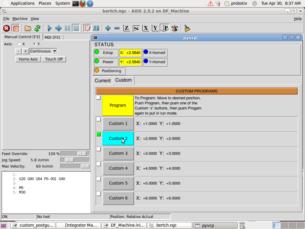

Is it possible to wrap text in a label? If so, what is the formatt?

I'm pretty sure pyvcp can not wrap text. I know GladeVCP can.

Figured it out...just use <wraplength>" "</wraplength>

Can you show me the full syntax of the label you make with wraplength?

<label>
<wraplength>"250"</wraplength>
<justify>"left"</justify>
<text>"To program: Move to desired position, push Program, then push Custom 'x' button, then push Program to run"</text>
<font>(Helvetica",10)</font>
</label>
This worked on button text as well.
Dave

What you discovered is amazing !
Is it really working with the existing pyVCP widgets (label,button as you told) or do you have a modified version ?

It is working with labels and buttons. Attached is a screenshot of using it for a label. Glad that I could finally contribute something instead of always wanting.
