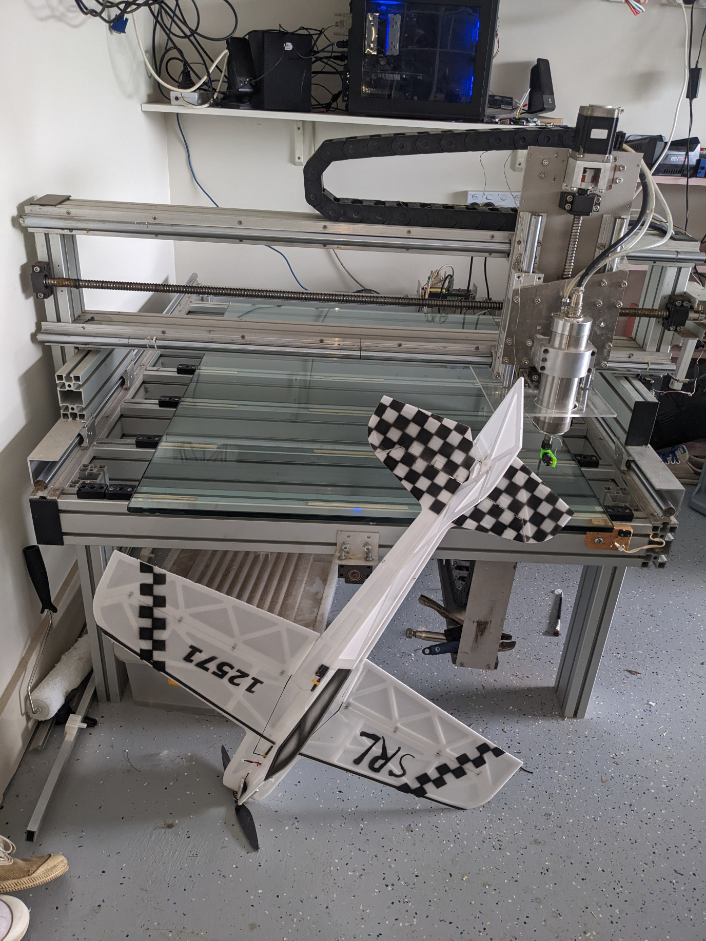

I am trying to learn to probe using my DIY rotary axis. My machine runs g code great but when I probe, I must run the machine painfully slow or I will get false probe triggers. I think this is due to vibrations in my machine and bouncing of the probe with movement. I understand that I can add "debounce" to the HAL file to require the probe signal stay tripped for a given length of time but I can't figure out how. I am very new to Linux and don't understand what the different HAL instructions do. Below is my HAL file, any help will be greatly appreciated but please try and keep it very simple.
Thank you
Joe
