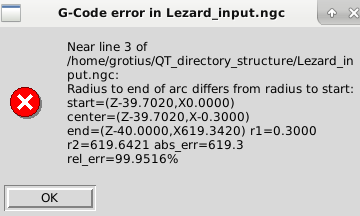

So, the files are around 30 Mb, one file is 1,120,000 lines, another 1,400,000 lines like below :
N50 G0 Z-38.
N55 G1 Z-39.702 F720.
N60 G18 G3 X619.342 Z-40. I-0.3 K0.
N65 G1 X619.035 Z-39.962
N70 X616.122 Z-39.958
N75 X609.333 Z-39.957
Yes, more info is better, when it's available... It is now, as I'm experimenting with Fusion360 CAM.
N50 G0 Z-38.

27 Jun 2019 18:50 - 27 Jun 2019 20:31 #138016
by Grotius
Replied by Grotius on topic Handling large files
Last edit: 27 Jun 2019 20:31 by Grotius.

Those are very big files, you are right. For G-code files.
Still pretty small compared to video files.
That, in itself, shouldn't be a problem, but you can probably make them a lot smaller by persuading the post-processer to use arcs.
You are likely to need to become familiar with the G64 command settings to make the most of your code.
