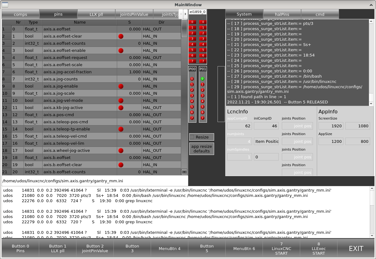

Hi!
i am writing a timeinterval-component, and i want to save same data in configuration-directory.
I have often seen the os.environ 'CONFIG_DIR' in python - i think this is what i need.
If i try to get this in c i get an empty variable:
my componet was loaded after linuxcnc was startet with
Is there a header-file to include to get more of linuxcnc-environment?
Greets from Bavaria
Freisei

21 Nov 2022 19:18 #257248
by udoS
Replied by udoS on topic How to read "Machine configuration directory" in HAL userspace component
Hi @freisei
I found a way to get the ini Directory; if thats what you where looking for;
Best Regards
Best Regards

22 Nov 2022 11:14 #257319
by udoS
@freisei
some pree condition:
Linuxcnc must be running;
If you start Linuxcnc then you can querry:
$ ps aux | grep "linuxcnc"
LinuxCNC starts with "/bin/bash /usr/bin/linuxcnc"
Now if you start LinuxCNC, LinuxCNC starts/calls for "halui -ini" and "io -ini"
If you querry now for
$ ps aux | grep "halui -ini" or
$ ps aux | grep "io -ini"
then you get as return the process info along with the path;
io -ini /home/udos/linuxcnc/configs/sim.axis.gantry/gantry_mm.ini
Here the code I have used in Qt 5.15.2:

- udoS
- Posts: 216
- Thank you received: 25
23 Nov 2022 06:27 #257429
by udoS
Thanks for the info;
@andypugh
How does that get me the path to a running linuxcnc ?
@dgarrett
I'm all in Qt and/or c++; No No No Python; what so ever;
with "The ini setting is also available in stat()" .. are you referring to NML ?
then what is the call for it ? could be used in the Lcnc_QtCpp_HMI;
What I have here is an interface into LinuxCNC/HAL in an attempt to build a Linuxcnc-IDE;
Qt 5.15.2, with Creator 8.0.1, c++17; any help Wellcome !
Best Regards
@andypugh
@dgarrett
Best Regards
