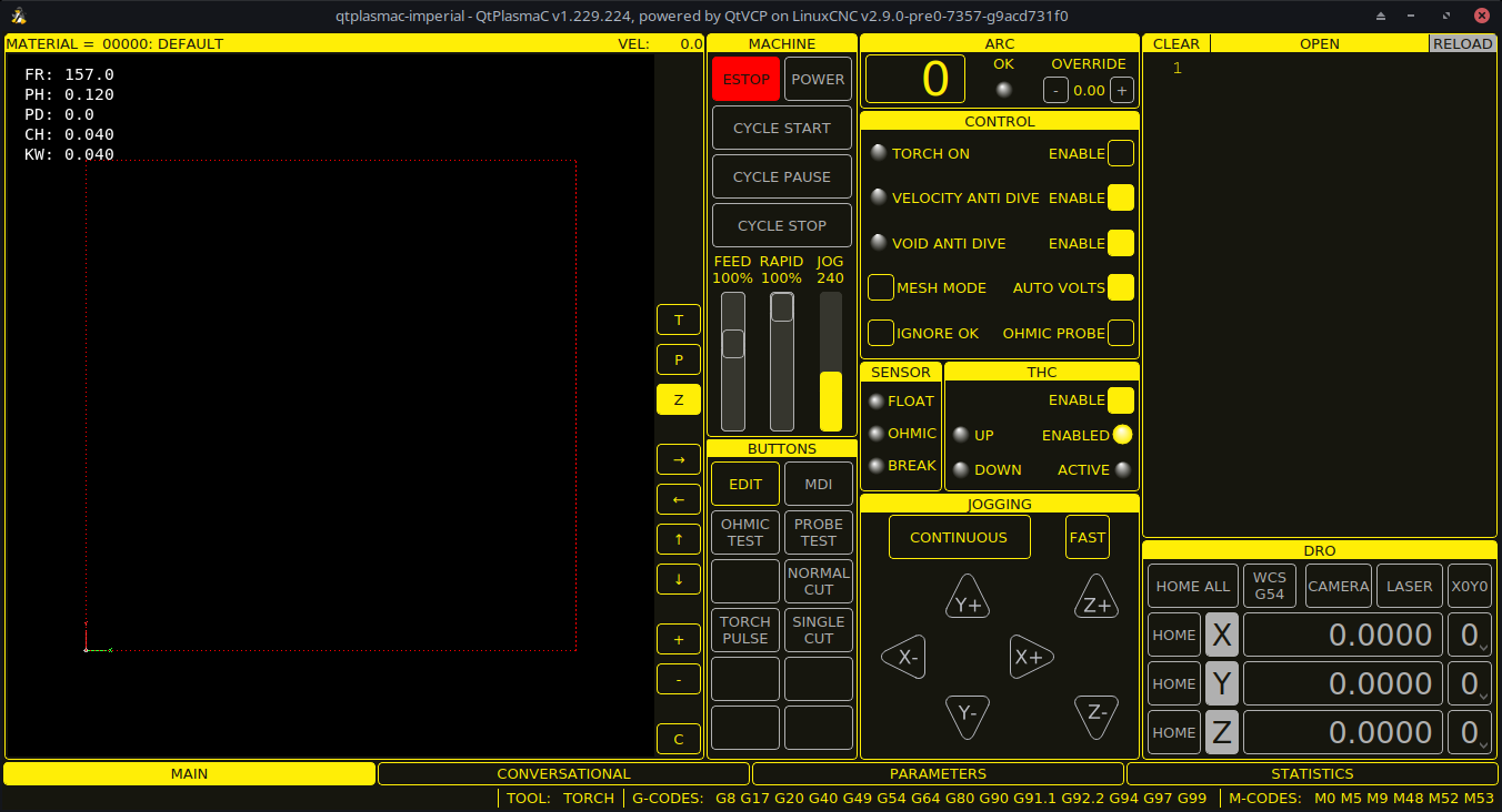

ok i was doing some test and noticed that it was only the 16:9 version of qtplasmac that doesn't work. i switched to 4:3 and it is working now. i already tried to do a complete removal and reinstall but it doesnt worked. anyway im now able to continue my work so its ok for now and i will wait for a new update. And after this i will no longer update it as long as a stable version of qtplasmac will be released. thanks snowgoer540 for this quick response time! have a great day!

Installed the package version on my test virtual machine. It worked fine:
So I am not sure what is going on over there. I assume in the Synaptic Package Manger that you did a search for "linuxcnc" and then you did "mark for Complete Removal" for all the packages there. Applied, and then searched, and reinstalled. I am also assuming that the latest version for you is 1:2.9.0~pre0.7357.g9acd731f0.

Nop the version i have is 2.9.0-pre0-7360-g962669b7a.
Yes in the synaptic package manager i did a complete removal of any linuxcnc result in the search. and then reinstall completely.
in the repository i have for deb and deb-src:
url: buildbot.linuxcnc.org/
distribution: buster
section: master-rtpreempt

Ok i did the update. And it was still not working but i finally fount the trouble and fix it!!! few weeks ago i did extract the GUI files in my machine setup to take a look at them and forgot them. So when i updated linuxcnc they where lo longer compatible with the new update... so i just delete theme and now its working!
