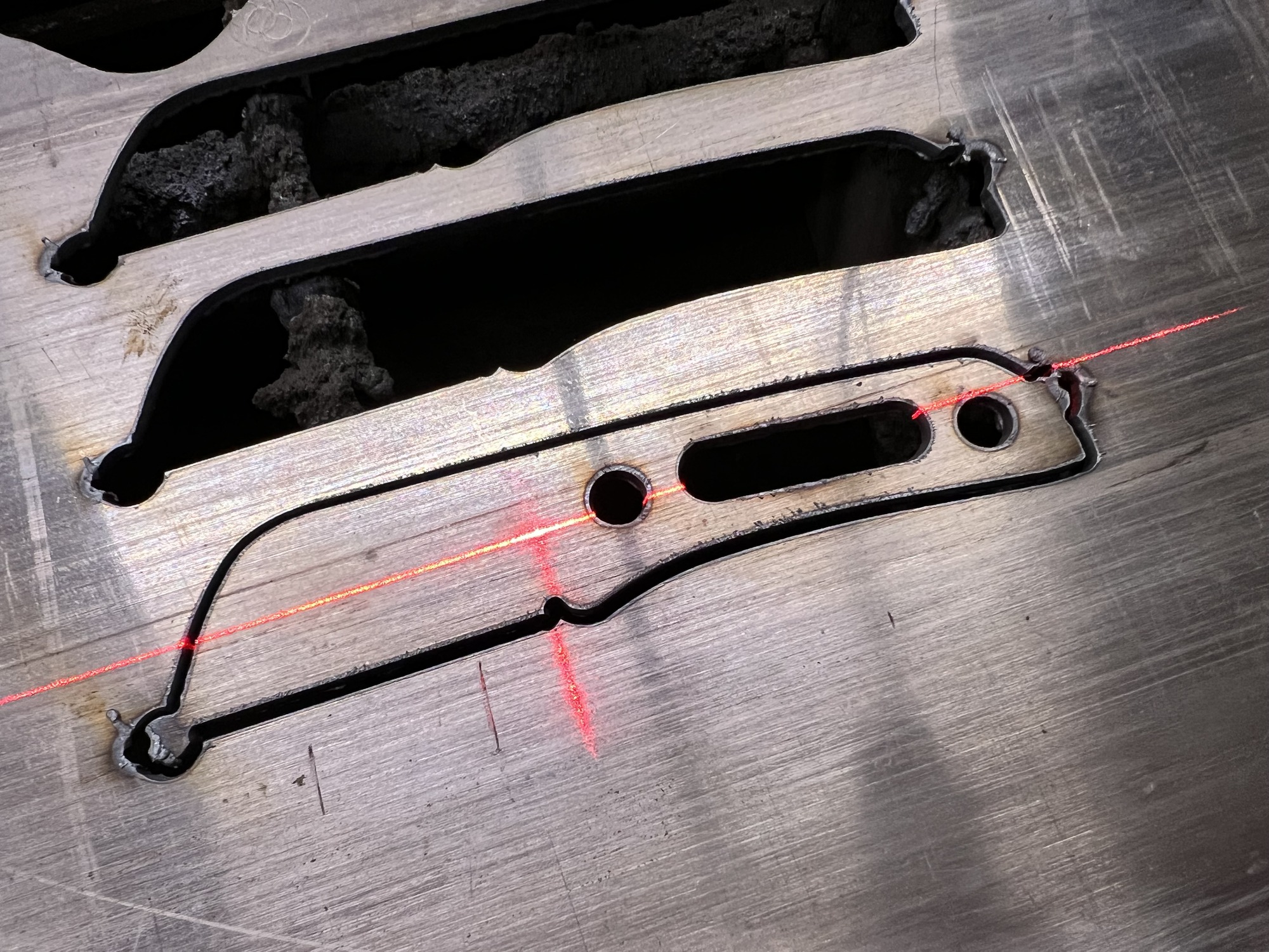

Thank you so much. I just tested it out and I do t know what voodoo you crammed into this new program but holy crap. It’s cutting better and way faster than it’s ever cut before. The ohmic is wicked fast and doesn’t even tap the part like it did before. Also I’m using the magic hole feature and it’s cutting these small holes amazing. 1/4” holes come out about perfect with no need to be drilled anymore. I wish I would of upgraded years ago. Huge Thank you to everyone that worked on this.
I’m cutting this at about 160” min which is 2-3 times faster than I was and the results are way better.

Still using the fine cut consumables but much faster cut rates. The slag pops right off now. You can see where I’m getting alittle wiggle around sharp direction changes so I’m not sure going up to 250”/min will be beneficial with the standard consumables.

I just watched your YouTube video on you high speed ohmic and it’s impressive. I’m sitting at 20”/sec starting at 1”. I tryied 50”/sec and I seamed to tap the sheet hard enough to float the torch up a smidge which is unacceptable as I normally use small 11x23” sheets of thin material and that hard of a tap can shift them. Abd these sheets are quite pricy at $200-$300 each. I would like to speed it up but if I can’t then I understand. Here is a video of the test cutting. Any recommendations?
