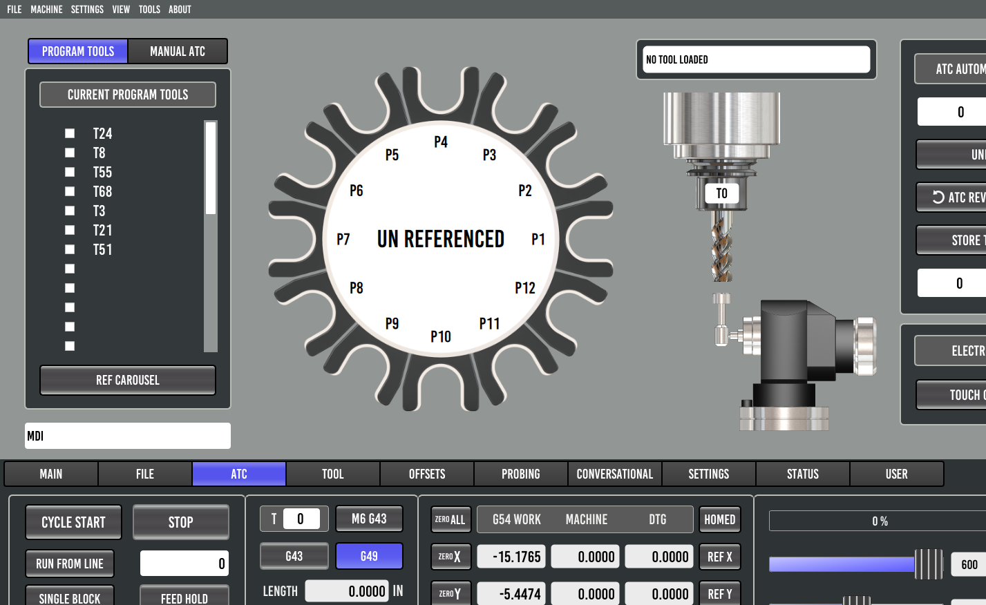

Hello, what i have to do or what i need in my Gcode file to see my needet Tools for this gcode in my Probe_Basic ATC Toollist?

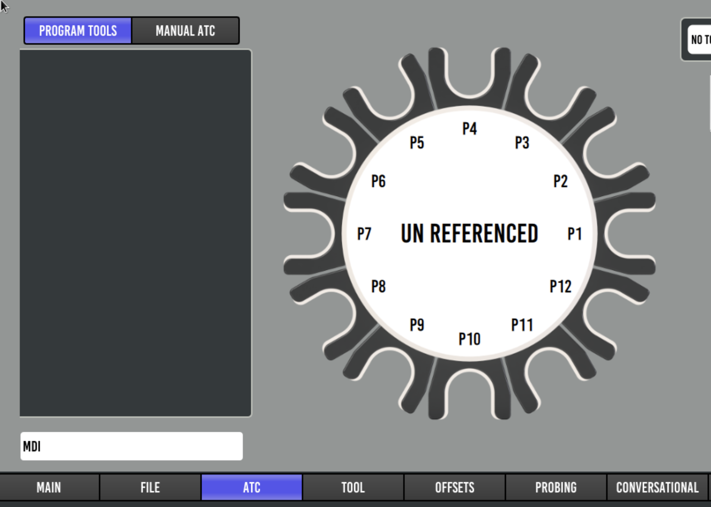

for sure my Tools are written with Toolnumber check this gcode.
but in Porbe_basic tool list i see nothing

it will write the programs tool list to make it easier to see what tools are in the carousel and what tools are not, i currently have to make a list on a post it for this and mean to try and read the top comments section of the program and print to a list that would be displayed here but ive not looked at it in a while with everything else we have been working on. with the new manual toolchange request widget, there may be some code in there that helps perhaps.Yes thats what i mean!

ok yeah that´s a nice feature. comes it with an manuel or an how to include it?
found this:
maybe this will help you
found this:
