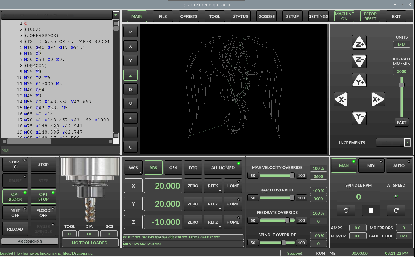

I just uploaded the files to make QtDragon work with VTK. It's functional, but not as versatile as qt5_graphics. There's also the .deb package you need to install VTK. My ultimate goal was to make it look like qt5_graphics but there are some GL functions not available in VTK. I also explored porting to OpenGL ES but that's another whole can of worms. github.com/persei802/vtk Place them in your config directory, replacing the current ones.
Here's a screenshot of QtDragon on a RPi4
Problems? Let me know.
Jim
Jim
