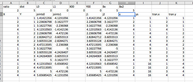

I've been working on this and I've been trying to get the bipod style program to work. It is the example from the manual kinematics - two steppers with wire/string dangling between them.
My kinematics, hal, and ini are attached. I start the program, home each joint with the starting x,y near the top left joint (see HTML docs ). My +/- x moves works without a problem, but the +/- y moves don't. It looks like joint 2 is going the wrong way. I can tell some math is happening in there, because as I increase Y, the steppers get faster to keep the same Y speed.
Any ideas what would be causing that behavior? I can't find a problem in my math, increase joint (joint mode) causes the length of the string to get longer. That is why my code has joint[1] = -sqrt((Bx-x)^2+y^2). If I wind joint 2 the opposite way, and remove the negative, I get the same behavior.

20 Jun 2012 20:27 - 20 Jun 2012 20:27 #21157 by andypugh
Replied by andypugh on topic Re:Custom Kinematics
I tried it in Excel, it only works if you change
Bx2 to = Bx, but you have:
double Bx =0;//= parMain -> dist;
Last edit: 20 Jun 2012 20:27 by andypugh.
20 Jun 2012 20:32 #21159 by tmade
Replied by tmade on topic Re:Custom Kinematics
And that is getting me better results. Thanks for taking a peek at that for me.
