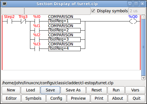

- BigJohnT
- Posts: 6999
- Thank you received: 1176
25 Mar 2013 19:04 - 25 Mar 2013 19:14 #31836
by BigJohnT
Replied by BigJohnT on topic Hardinge HXL Tool Turret
Right off the top of my head and not tested if you changed the comparison to be similar to the following it should work. The comparison blocks compare the tool request number to a constant. So if the tool requested is 1 and the prox for tool 1 is on the rung will be true.
Work out each rung one at a time to iron out the bugs.
John
John
Last edit: 25 Mar 2013 19:14 by BigJohnT.

- BigJohnT
- Posts: 6999
25 Mar 2013 22:29 #31856
by BigJohnT
No, you have an input for each tool. The wsum is used if you have a binary number from an absolute encoder like I do.
The 4 compares reject the wrong input based on the tool prepare number. For example if tool prepare is 3 and the input for 2 is on nothing happens until it goes round to 3 then you can stop and drop and wait for the down prox. I'll try and work up an example conf that you can run and see what is happening. I actually have it half done but had to stop and do some paying work...
John
So with this ladder logic wsum is no longer used?
John
