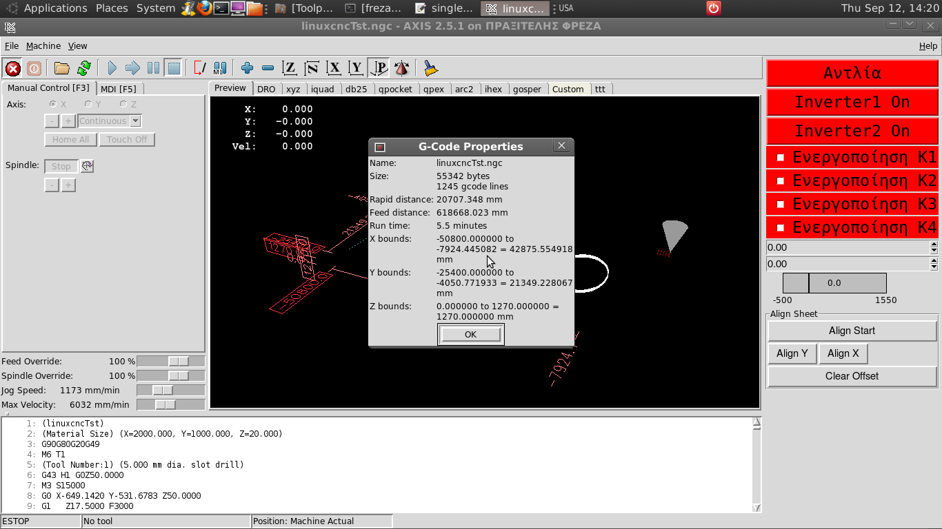

16 Sep 2013 17:25 #38876 by umbaman
Replied by umbaman on topic Milling Machine Multiple Heads
I used the postprocessor to create the ngc code, but the output is kind of wired.
I have attached the postprocessor, the screenshot that shows the bounds, and the code generated.
The bounds are way to big for my machine. The limits for my machine are 2000x1000x220 mm (XYZ).
Could anyone guess why I get this output? In Artcam i setted the surface area to be 2000x1000 (XY).
Thank you all very much for your time.
