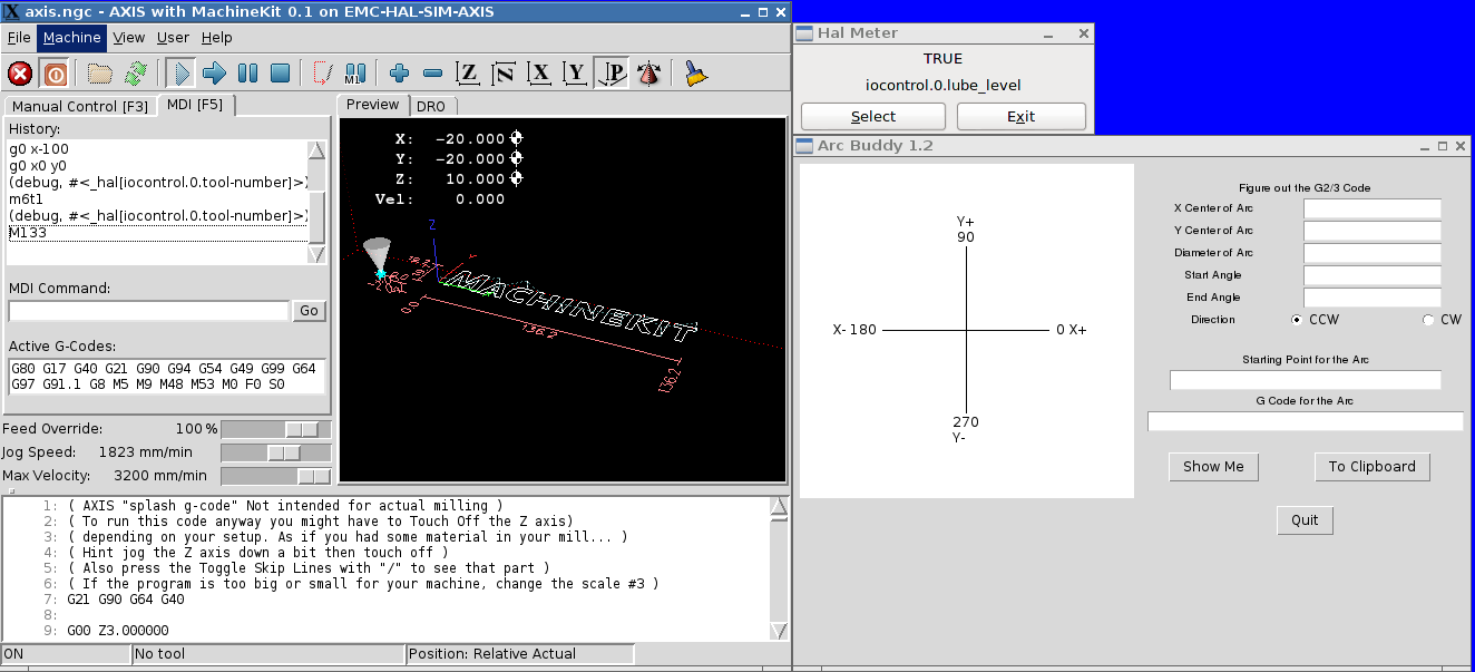

13 Apr 2015 23:14 #57760
by ArcEye
Replied by ArcEye on topic User defined M-code calling python script
This M133 script runs a halcmd and then opens JTs ArcBuddy, which is a python app
What I meant by the header to specify the processing app is in the first line of arcbuddy.py
This is not present in this form in a lot of python scripts, they reference python-env, which may or may not be set
The result is
(ignore the fact that it is Machinekit, I had that loaded at the time)
So you can set a pin and then open a python app if all is correct
regards
#!/bin/bash
halcmd setp iocontrol.0.lube_level 1
arcbuddy.py
exit 0
#!/usr/bin/python
The result is
regards
