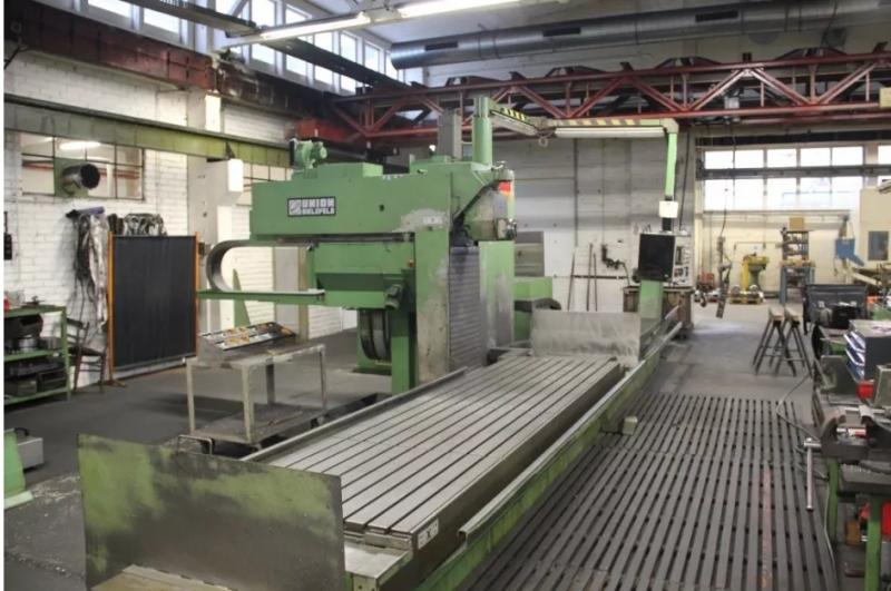

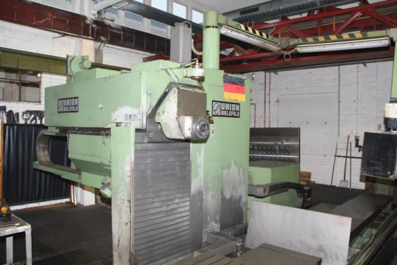

09 Mar 2016 14:19 #71278 by REEEN
Replied by REEEN on topic Tool compensation switching plane
Thank you very much Andy :)
Iam using gmoccapy gui for all our machines, it is very important for us to use this gui, because our control panell is created directly for it.
I thought that kinematics are independant from the gui...
I hope it will work with gmoccapy.
My mill is a bit different from yours the tilt head is 45 degree to z axis so the tool will either place towards the user or vertikal.
The head only has to positions that will be hal driven.
Here is a picture:
It is a very enormous machine.
Greets Rene
