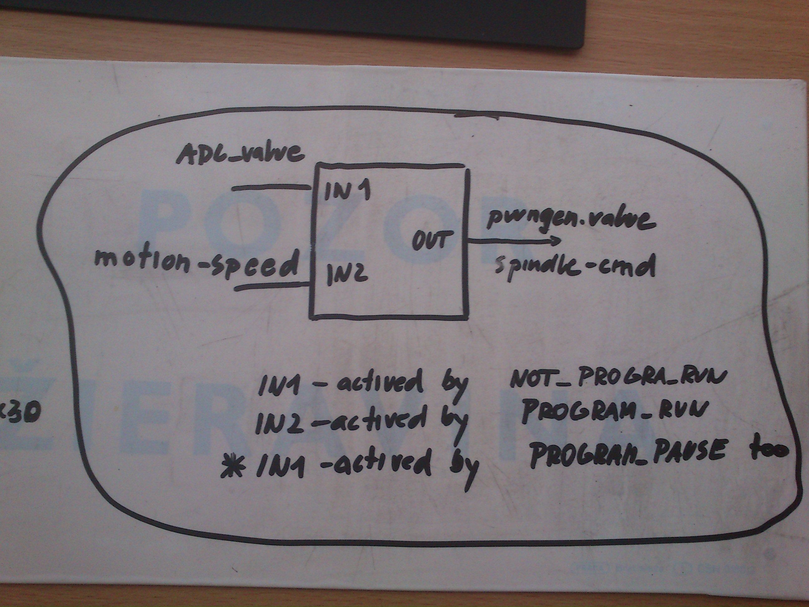

Hi. I use axis configuration to control my CNC machine. I have motor with PWM control (0-6000RPM). I have external control panel (JOG,Emergency, axis button, etc.) with potentiometer to set speed of motor. I set ADC converter and check it. It works. But if I use manual control potentiometer to set RPM, a G code "M3 S1000" doesn´t work. This is code for automatic spindle on (motion.spindle-speed-out is set by "M3 S1000"):
net spindle-cmd <= motion.spindle-speed-out => pwmgen.0.value
net spindle-on <= motion.spindle-on => pwmgen.0.enable
I use this code (I don´t know, how use two INPUT to set pwm.0.value):
net ADC_value => pwmgen.0.value
net SPINDLE => pwmgen.0.enable
This code can´t start motor by "M3 S1000". Can I combine this two different setting? Thanks.

I want set PWM two ways continously. But i don´t know if it is possible. So,when I set knob to 50% value (3000RPM), motor spindle is 3000 RPM. Then I use M3 S5000 and motor spindle increase to 5000RPM. If I rotate knob to 60%, motor spindle decrease to 3600RPM. Can I make the rule "last change of spindle win" ? (sorry, I don´t explain it better

I have 12-bit ADC(4096 unit).
Conversion ADC_value is a function. While ADC_value is less than 100, out value is 0. Increase and decrease have step 50 units. (0,50,100,150,200, etc.) I use this solution for constant spindle.
But if it is not possible, I prefer this solution:
If i don´t use RUN button, i use for control spindle potentiometer. If I start G code program, the potentiometer isn´t work.

Replied by andypugh on topic Add external Speed control potentiometer--HELP
You need a combination of mux components to steer one or other signal to the spindle speed output pin. You would select the mux on the basis of the machine mode HAL pins.
You might also need to use more mux components as a sample-and-hold function (you can feed a mux with its own output to achieve this, the dedicated sample-hold HAL component is S32 data type for some reason). You would subtract the sampled-value from the current value as a way to get some of the behaviour you want.

Yes, that's the simple version.
Don't forget that net commands need a signal name, and pin names have to be exact:
net ADC_value => mux2.0.in0
net motion.speed-out => mux2.0.in1
net scale1 mux2.0.sel0 <= halui.program-is-run
net ADC_value hm2_5i25.0.analogout-00 => mux2.0.in0
net spindle-command motion.spindle-speed-out => mux2.0.in1
net spindle-select halui.program.is-running => mux2.0.sel
net selected-spindle mux2.0.out => pwmgen.0.value
