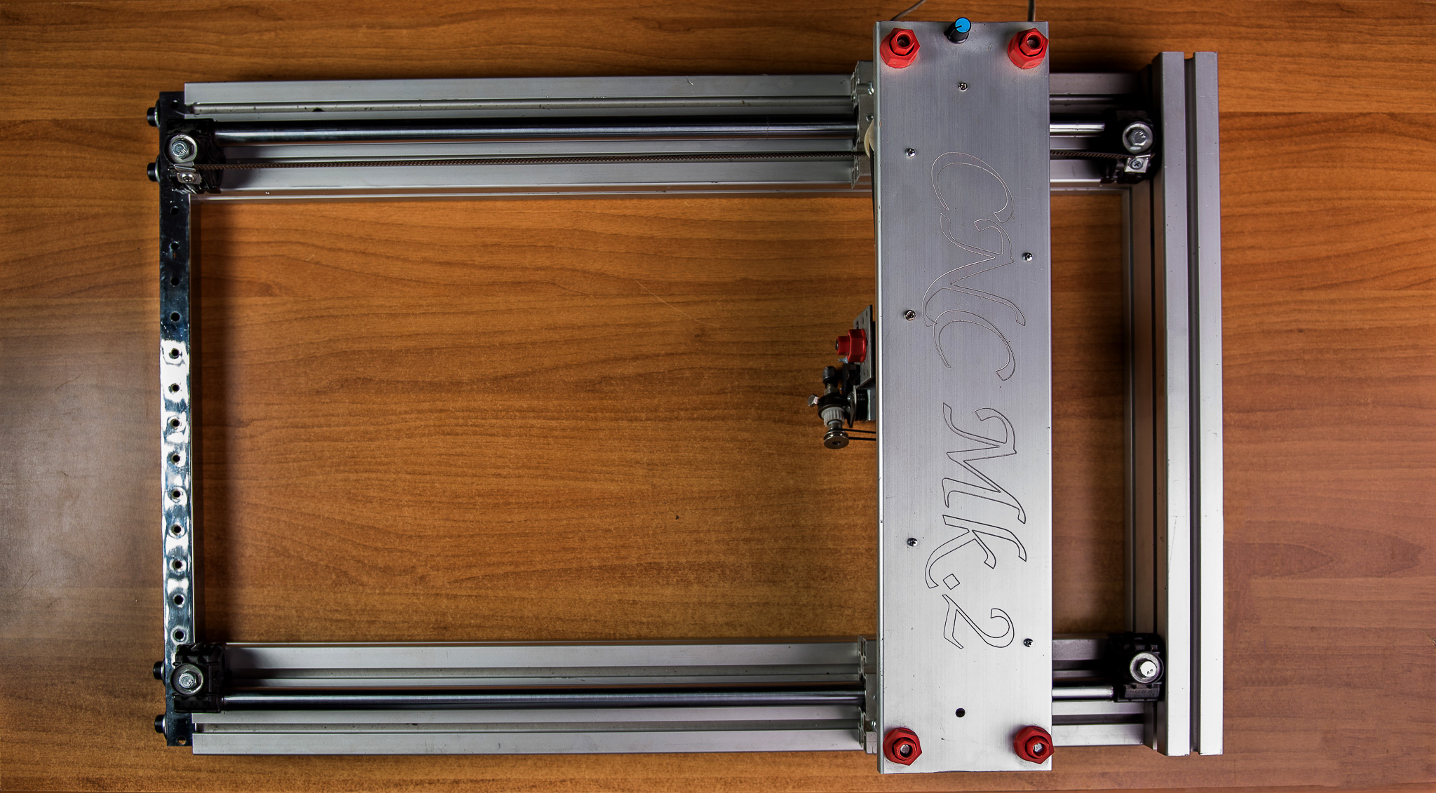

I have a problem, namely, spent 5 hours yesterday trying to configure one of the parport pins to output a PWM value depending on the Z axis depth.
I build engraving machines for stone or glass or whatever you put under it, as they use a diamond bit at high speed to scratch the surface, mounted at an angle 15-20 degrees, with another motor doing the pressure on that bit.
Here are videos of 3 of them working, so can see how it all works and they can do.
Now i need to make that work with Linuxcnc, so image2gcode can be used for generating the tool path, but i need the Z axis values to output PWM on a pin, strictly dependent on that Z axis value.
I did try the M3/M5 route, M67/M68 but it is not what i need, and it will not work.
Just a nudge in the right direction (if any exist) would be appreciated.

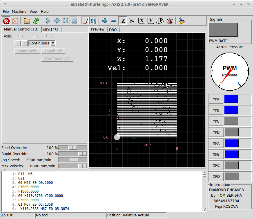

I also need to know if there is away to have the picture that image2gcode used to generate the tool path, show in the preview screen in AXIS, that would be awesome.

- Online
- Posts: 21029
- Thank you received: 7163
17 Jul 2016 21:59 #77583
Replied by tommylight on topic PWM depending on Z axis walue ? Superimposing a pic
Done, the actual test still remains undone since i am finishing 2 new machines and i do not have anything ready to test on, but i have paraport testers with LED that show exactly what is needed for the hardware, signalling wise.
I am attaching the complete config for anyone that wants to endeavour into making that type of machine.
Now some more info:
The config uses quadrature outputs for steppers that can be changed to step/dir or anything else,
It has a VCP panel to show what is going on with output pins,
It uses milimeters, not inches, again easily changed if needed,
The software used for image to gcode is dmap2gcode from
www.scorchworks.com/Dmap2gcode/dmap2gcode.html
with utmost respect for them,
Image-to-gcode that is included with LinuxCnc works, but it uses G2 and G3 on the X-Z plane so it need a lot of cleaning, while dmap2gcode needs just replacing the Z with an S and removing the negative values.

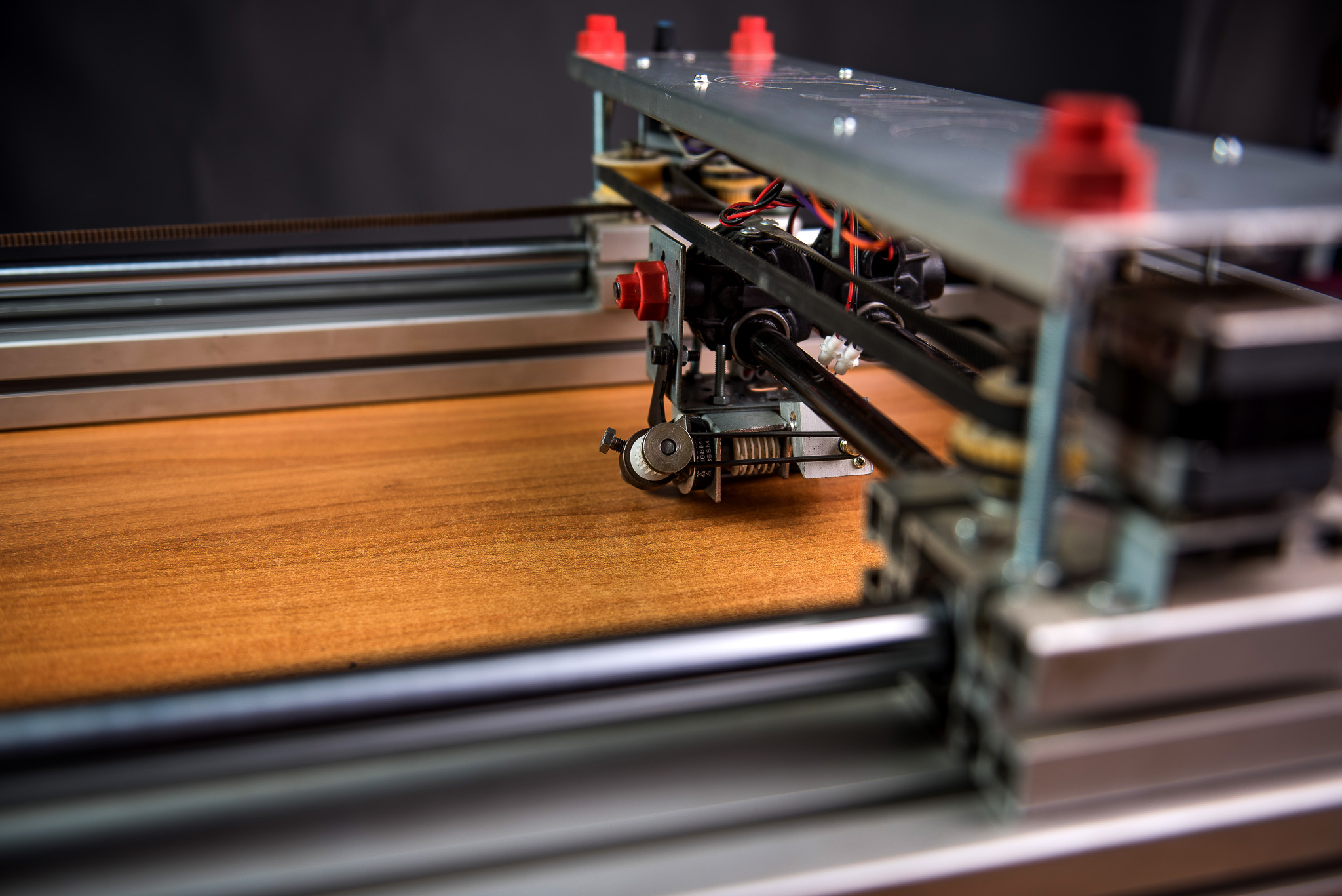

Now some details of the machine:
Everything except the head assembly is and can be same as any cnc machine with regards to X and Y axis so any router or plasma or mill can be modified for this, the head or Z axis needs a bit more details.
The head assembly is made of one bigger DC motor with a mount attached to its shaft for mounting another high speed spindle ( has to be light weight under 50 to 60 grams to work ), to drive the high speed spindle there is another DC motor mounted somewhere else on the head assembly that drives the high speed spindle via a small belt, powered directly from 12 or 24V DC depending on the motor, it does not need speed control, the faster it can spin the better.
That bigger motor is driven by a NPN darlington transistor controlled from pin 2 of paraport in my case, can be changed to whatever, on the negative side, while the positive wire from power supply goes directly to it.

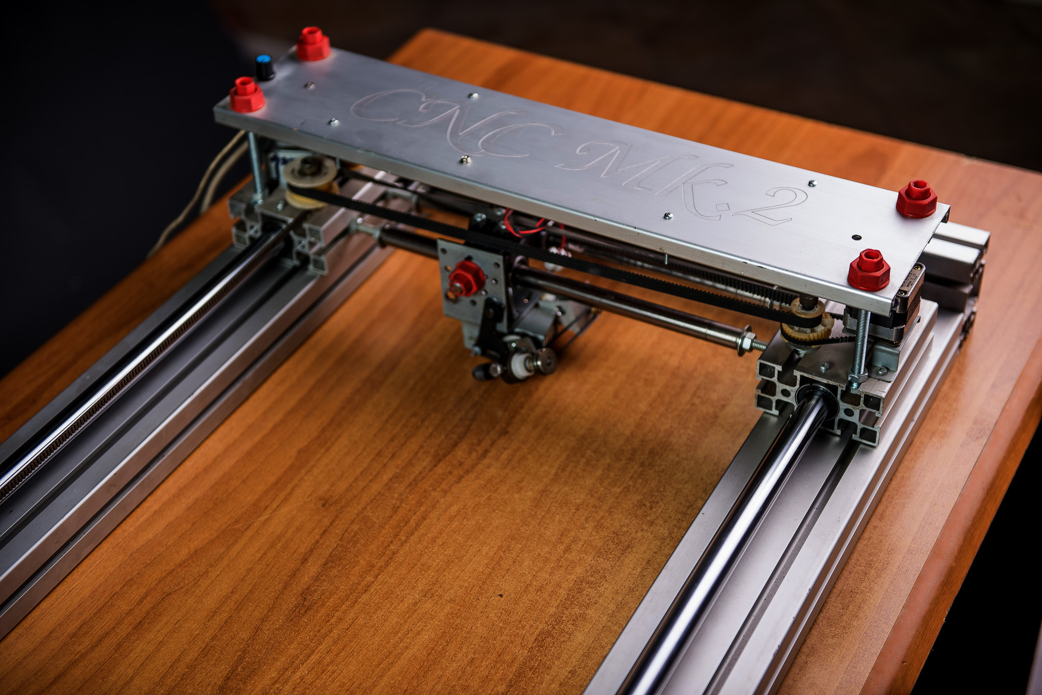

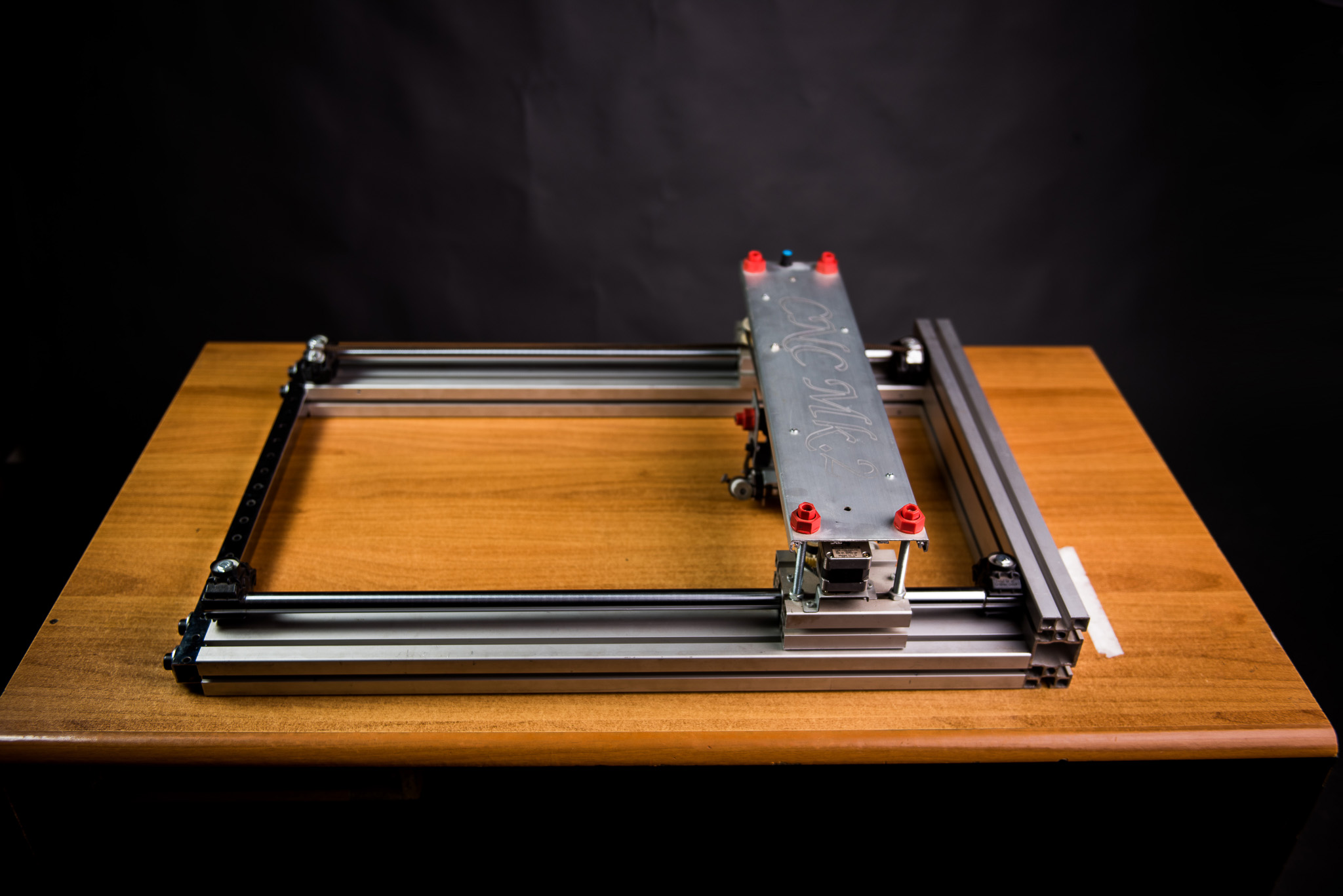

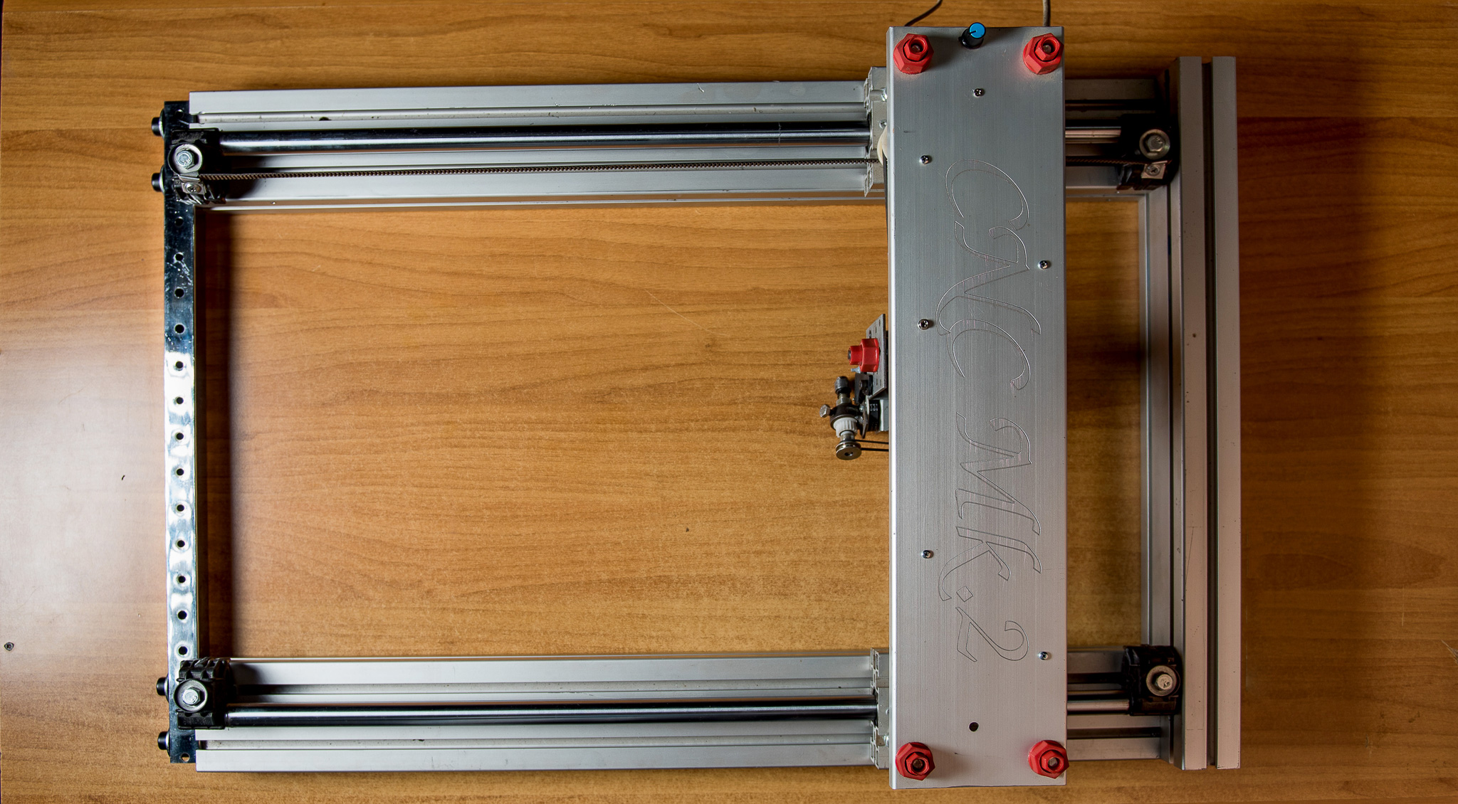

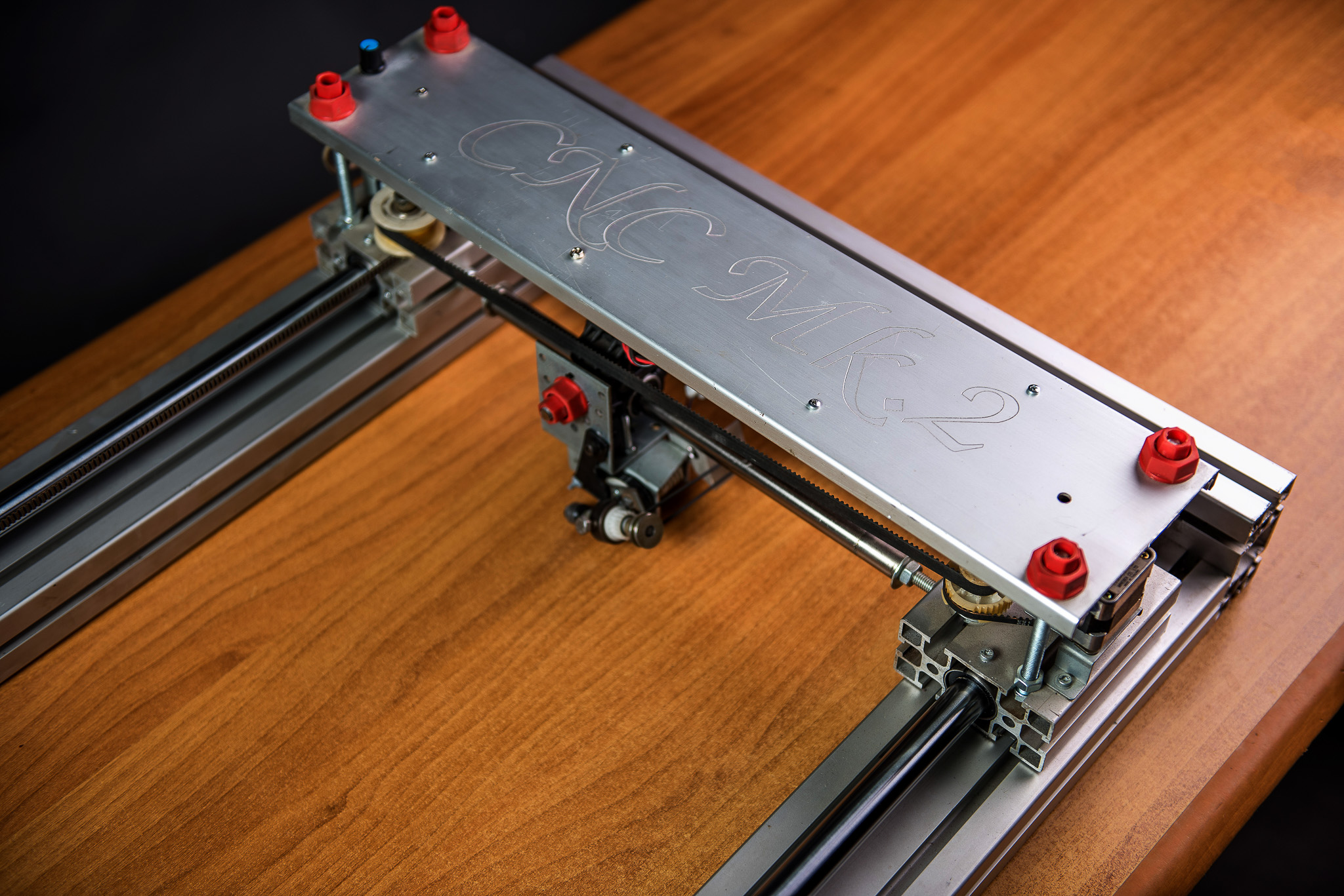

Here are pictures of the last one i built, might be easier to see the details of the head assembly.
Now some more info:

- Online
- Posts: 21029
29 Jul 2016 00:36 - 29 Jul 2016 00:38 #78121
That did not work as i was hopping, so i modified the config to use a spindle PWM, so i just need to change the Z with an M67 E0 Q........<Z axis values here, and make negative values positive from 0 to 10, did a PWM scale of 10 so now it does what it should for the machine. Still slows down on some parts while running gcode, but it is bearable.
Now i have to figure out dmap2gcode to output some more reasonable values, as a dark gray shade goes to 6 or 7 and that is unacceptable for my setup.
I will upload the new config tomorrow.
Tom

- Online
- Posts: 21029
20 Sep 2016 22:27 #80696
What are the chances of superimposing a picture on the plot screen when i open a gcode file?
Basically i need to have the picture of the job running on Linuxcnc so i will attach the screen shot and the actual picture. I need to see that picture behind the toolpath, or in front but transparent.
