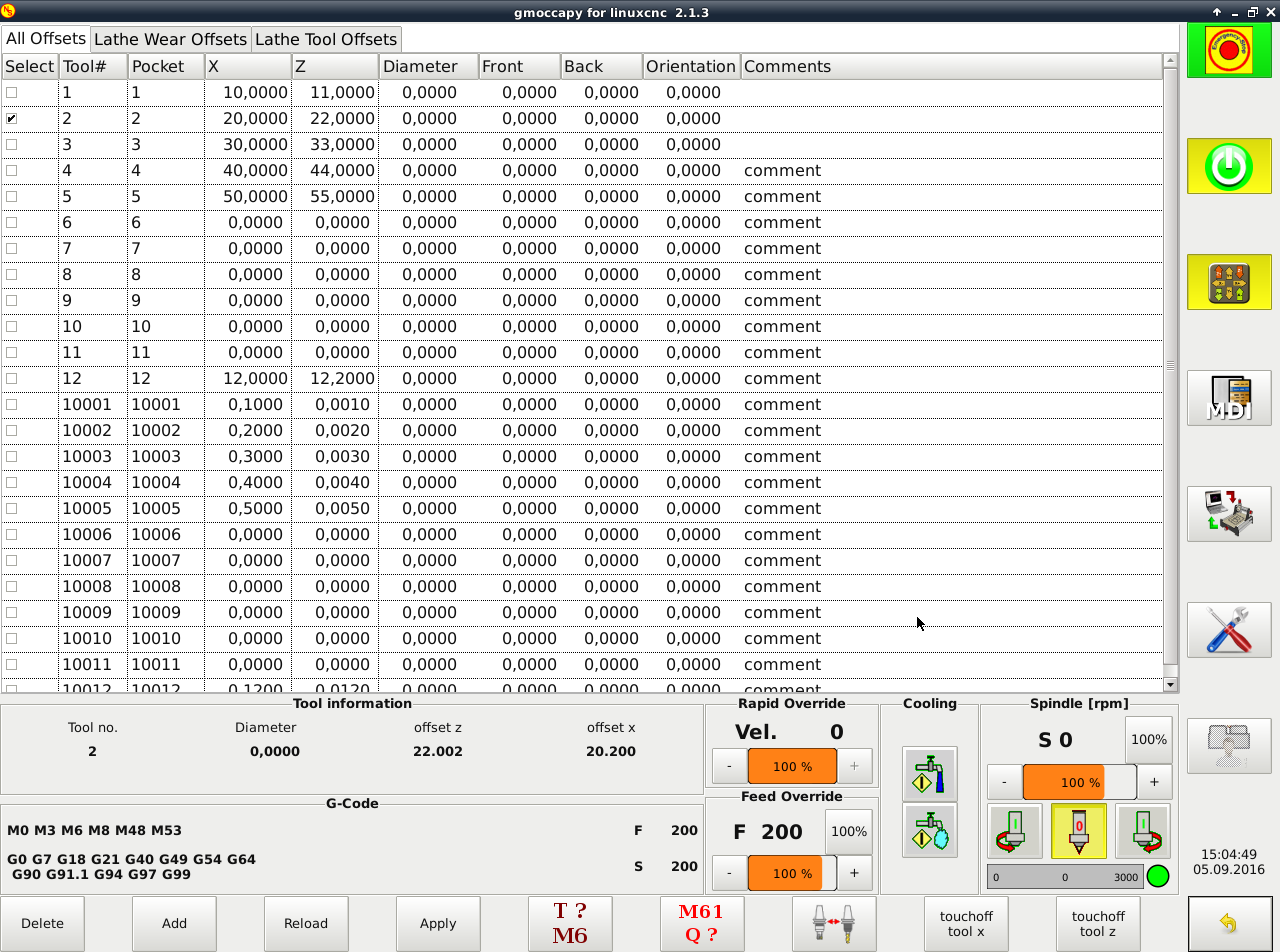

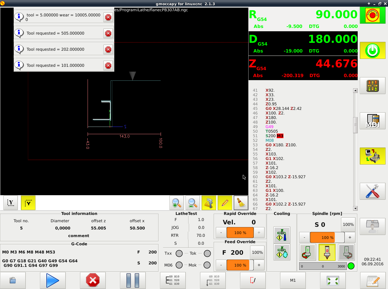

I tried config sim/axis/lathe-fanucy ,
1. - program start and finish normal .
2. -chosen row 49 ,
3.-Run_from selected line
....info tool requested=101 .. !!!??? why ?
....info tool requested=202 .. !!!??? why ?
....info tool requested=505 .. this should only !!!!!
How should I fill tooltable
Tool 1 wear 10001
Tool 2 wear 10002
Tool 12 wear 12012 ????
Thanks advance

06 Sep 2016 03:19 #80063
Replied by cmorley on topic Tool wear in tool table ?
yes this is right.
tool 12 wear would be 10012
As for the run-at-line problem. I'm not sure.
Run-at-line is implemented badly in linuxcnc - it may be run-at-line is changing tools not sure...
could you post your program?
Chris M
Chris M

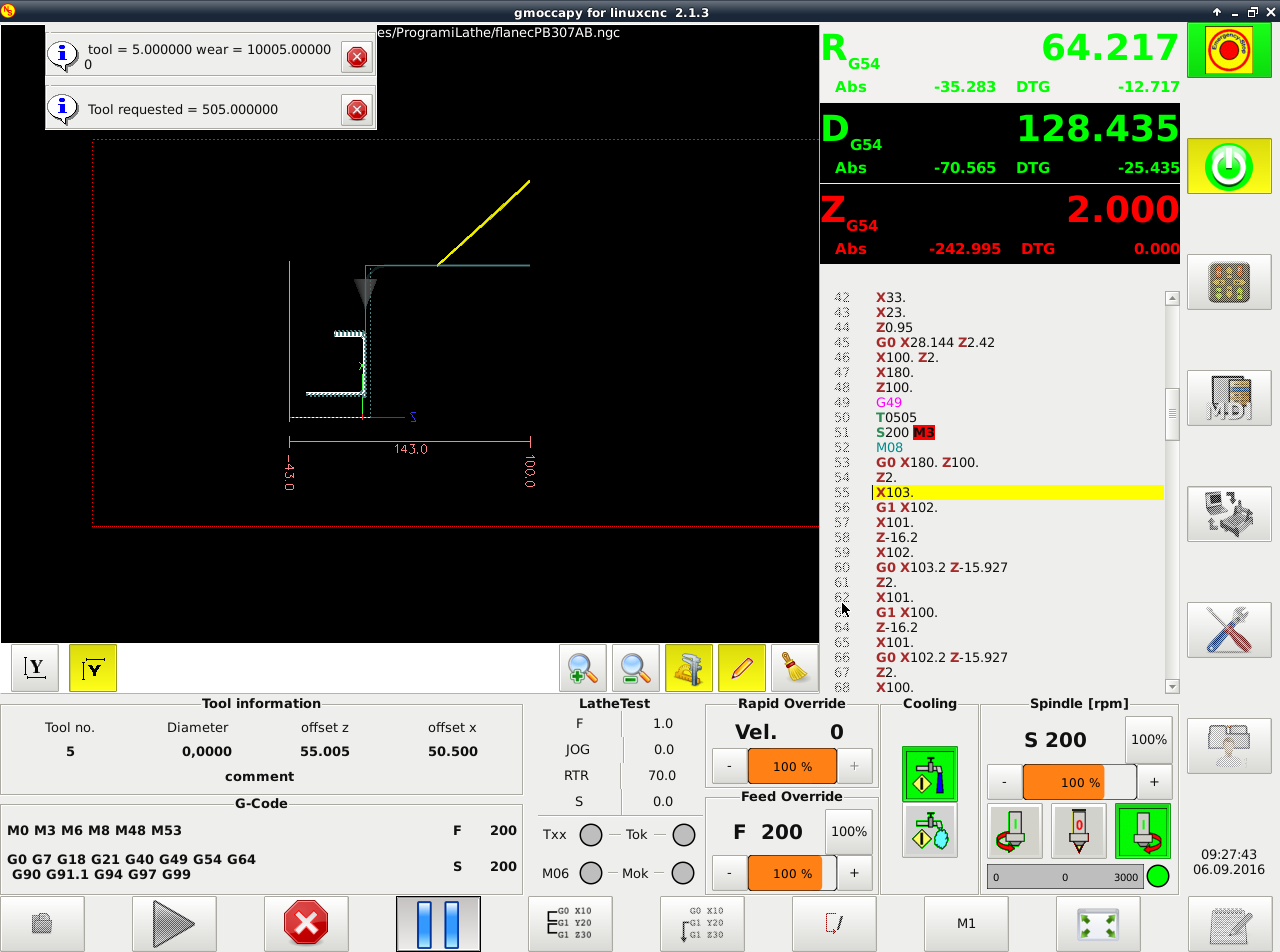

1.If we start from the beginning - no problem
2.Very useful tool wear in tooltable !
3.But we need when setting program use " run-at-line "
..If we start from line
.....G49
T0505 ..
remap wants to put previous tools
4.If I hide previous tools
( T0101 )
( T0202 )...
and start from line
.....G49
T0505 ..
Then remap work properly
Is it possible to avoid hiding previous instruments?
I confirm the problem.
I'll try to look into it tomorrow
Chris M

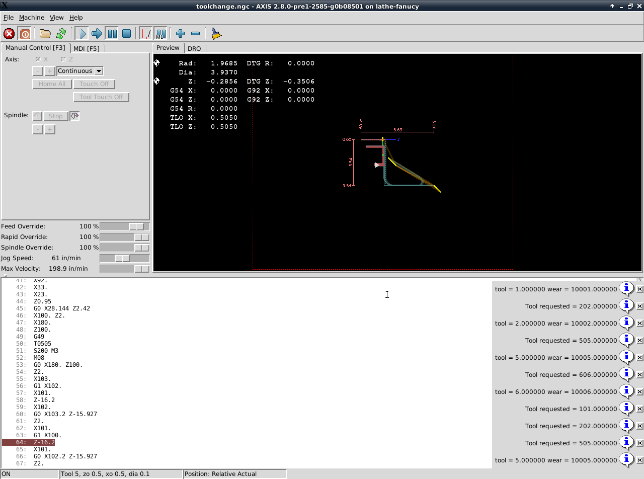

Replied by nkp on topic Tool wear in tool table ?
I think that "the bug" in remap.
The following code works fine:ini:
#REMAP = T prolog=get_T_number ngc=toolchange
