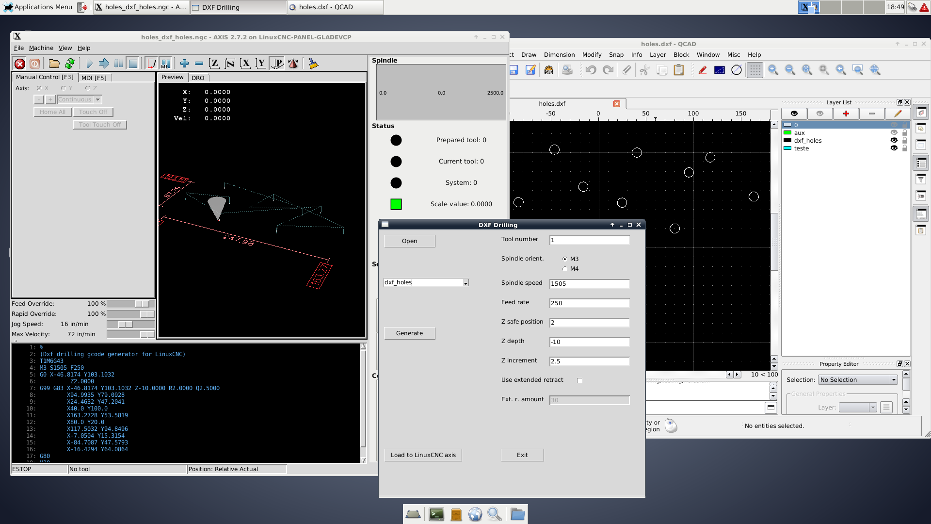

I am looking for a python script that will allow me to drill multiple random holes. I know nothing about writing my own script, but am not against trying to learn or modify one to work for me. Thank you in advance for anyone that can get me pointed in the right direction.

Probably poor choice of words. I would like to enter my drill locations.

21 Dec 2016 15:55 #84493
Replied by Todd Zuercher on topic python help
Have you looked at NGCGUI or NativeCAM (formerly known as Features)?
linuxcnc.org/docs/html/gui/ngcgui.html#_...ation_configurations
forum.linuxcnc.org/40-subroutines-and-ng...-is-features-renamed
21 Dec 2016 16:09 - 21 Dec 2016 17:54 #84494
Replied by andypugh on topic python help
forum.linuxcnc.org/38-general-linuxcnc-q...ideas?start=10#82686
Might be a reasonable starting point. It's an embedded tab that performs simple repetitive motions.
In your case you would set it up to use a peck-drilling cycle.
linuxcnc.org/docs/2.7/html/gcode/g-code.html#gcode:g80-g89
Or, you could just use a peck-drilling cycle. This G-code is not much more difficult that write than filling out a table.
G0 X0 Y0 Z10
G98
G83 R1 Z-10 X1 Y10 Q3
X11 Y10
X21 Y10
X21 Y20
G80

Thank you, I will look into the suggestions. I understand it that it is simple to hand code this, but I am looking for something that an operator (one that only knows enough to push the start button) could do.

Looks interesting. How hard is it to modify for someone not knowing anything about scripting?

It can be challenging if you don't know nothing about programming...
