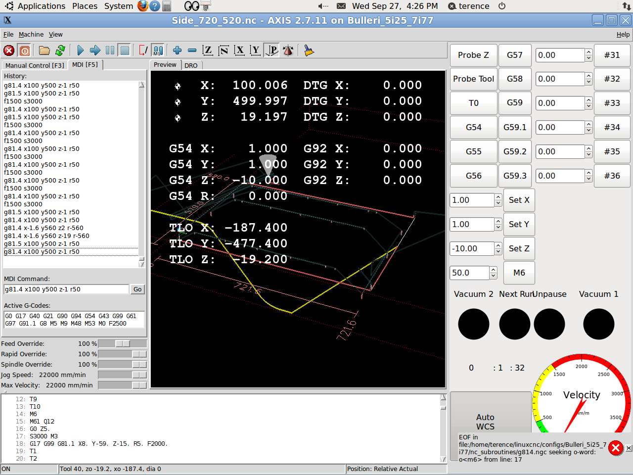

Hello,
I am currently in the process of implementing an automatic tool changer to my setup (3 axis router), hence the need to remap M6. I decided to go for an all python approach:
REMAP=M6 modalgroup=6 python=m6
Toolchanging works fine when called from MDI, however an error "Bug: call stack underrun" is happening when a Txx M6 is called from another remapped cycle, also implemented in python:
REMAP=G81.5 modalgroup=1 python=g815
Would you have any insight about this? Thank you for your time

So I have decided to rewrite the G81.5 cycle, but this time in gcode, and remapped as G81.4, using the default cycle prolog and epilog. Works perfectly except when an M6 is called, this I'm getting an error as per attached image.
Seems like it is looking for an o<m6> subroutine, but frankly I don't know where to put it given that I have remapped M6 entirely in python.

That is a bit strange. Are you sure that there isn't an ngc=m6 anywhere in your config by mistake?

There is, but it is commented behind #, as all comments go! I will try deleting completely but I have little faith this is the issue

Don't bother, commented out is commented out.
You might get a better answer from the Machinekit guys, the chap who wrote the remap code hangs out there now.
It might just be that you can't nest remaps, or that the remapped code needs to be on the top level.
(Perhaps you can call the python part of the remap from G-code as a custom M-code?)

The interpreter is very finicky when it comes to remapping in python. First it cannot run three python scripts in a row. When it does its read ahead and tries to run a remap inside another remap how will the interpreter get back? I don't think you can do that. It think Michael will tell you the same thing. Not sure.
What happens if you try and add the remap code in the G81.5 remap. Also try just running Tx in the remap and see if the bug is coming from the Tx or the M6. If it is coming from the M6, then you can run the Tx get the selected tool and hard code the toolchange in the G87
Just a thought.
Just a thought.

So what I have done as an interim (possibly permanent) solution is, nest functions rather than remaps.
def m6(self):
if m6func(self) == 1: return INTERP_OK
def m6func(self):
**all m6 code, returning a 1 rather than an INTERP_OK**
Calling m6func(self) directly from the G81.5 remap went well so far. Also I have been reading some of Bevins' threads about his remap. I have not been able to grasp the concept of "yield INTERP_EXECUTE_FINISH", did not notice any difference so far.
