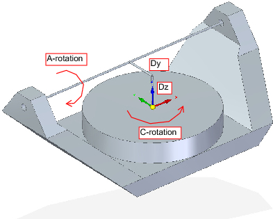

Hello everyone sorry if this post is repeated but couldn t find the answer, so here it goes:

where dy is the distance from a axis rotation center to c axis rotation center
and dz is the height from c table to a axis rotation center as explained on linuxcnc.org/docs/ja/html/motion/5-axis-kinematics.html
Is tool offset the tool diameter?
now how/where do i declare the offsets values? units for the offsets?
thanks in advance!

12 Nov 2017 11:10 - 12 Nov 2017 11:12 #101686
Replied by andypugh on topic 5 axis kinematics setup
I would expect "tool offset" to be the tool length. (especially with the line dz = dz + dt)
The offsets appear to come from HAL pins, are any created by the kins module?
