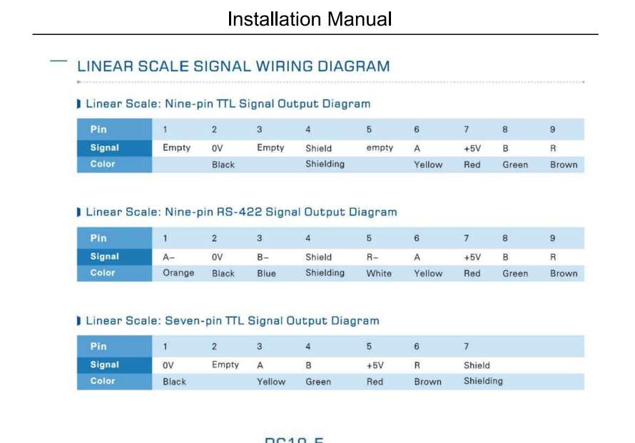

UPDATE
So I found the installation manual and I can navigate the installation and wiring with the exception of knowing what the 'R' input is on the attachment??
I'll update once I have the scale.
Jools

Replied by Todd Zuercher on topic Connecting a glass linear scale to linuxcnc
Most likely an index signal.

12 Dec 2018 15:01 #122271
by Hakan
Replied by Hakan on topic Connecting a glass linear scale to linuxcnc
R is most likely Index signal. On my linear scales there are index dignals every 50.000 mm. 1 um resolution is better, but depends on what you need. Means more pulses/second and lower top speed. Ttl signal level is what you need.
If it is only for creating a compensation file it is probably ok, there is no hurry.
I use mine for active feedback control and need to travel faster and generate more pulses than a BOB can handle. They are sino ka300/1 um/ttl.
