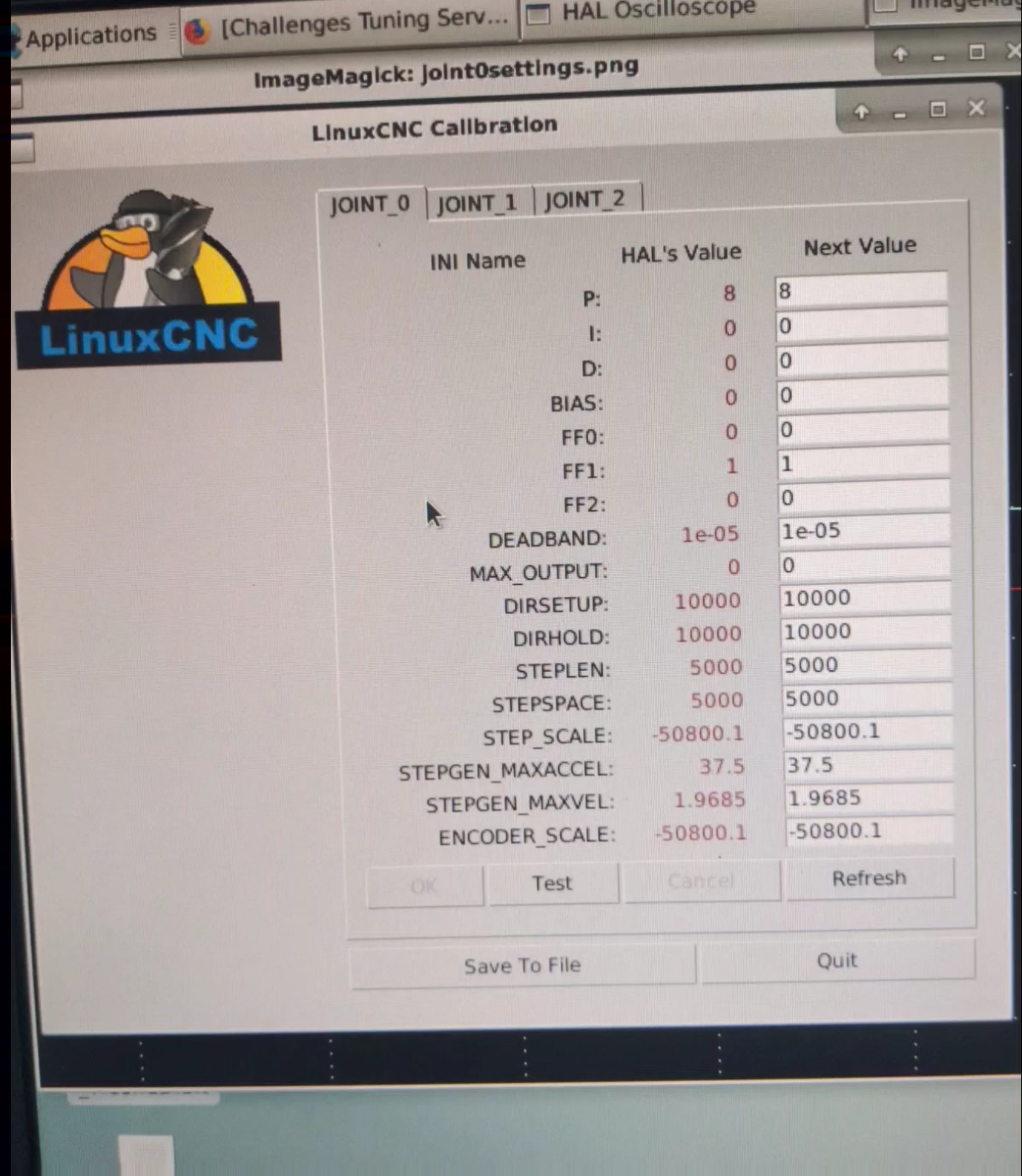

I have now followed Tommy's guide and upped my P untill oscillations occurred after a short jog, then backed off untill they cleared. At that point the joint.n.f-error would spike up relatively stabilize above the command line and after releasing the jog would drop back in line. From there I upped my FF1 untill the joint.n.f-erro would peak up for a split second and while continuing to hold the jog would the run centered on the commanded line. Now that I have accomplished this I now have an oscilattion that occurs after releasing the jog as shown in the video at this link: Current HAL Scope with oscillations
This is a photo of the settings that were running in this video and are current now:
I am trying to figure out where to go from here. If I dial back my FF1 to clear the oscillations my error goes out, and vice versa.
There is a good chance I also have some additional setting wrong that needs to be resolved to actually tune correctly.
I appreciate any help!

Can you post your hal and ini files?
If this is a step/dir driven system, FF1 must =1.000, its not something you tune

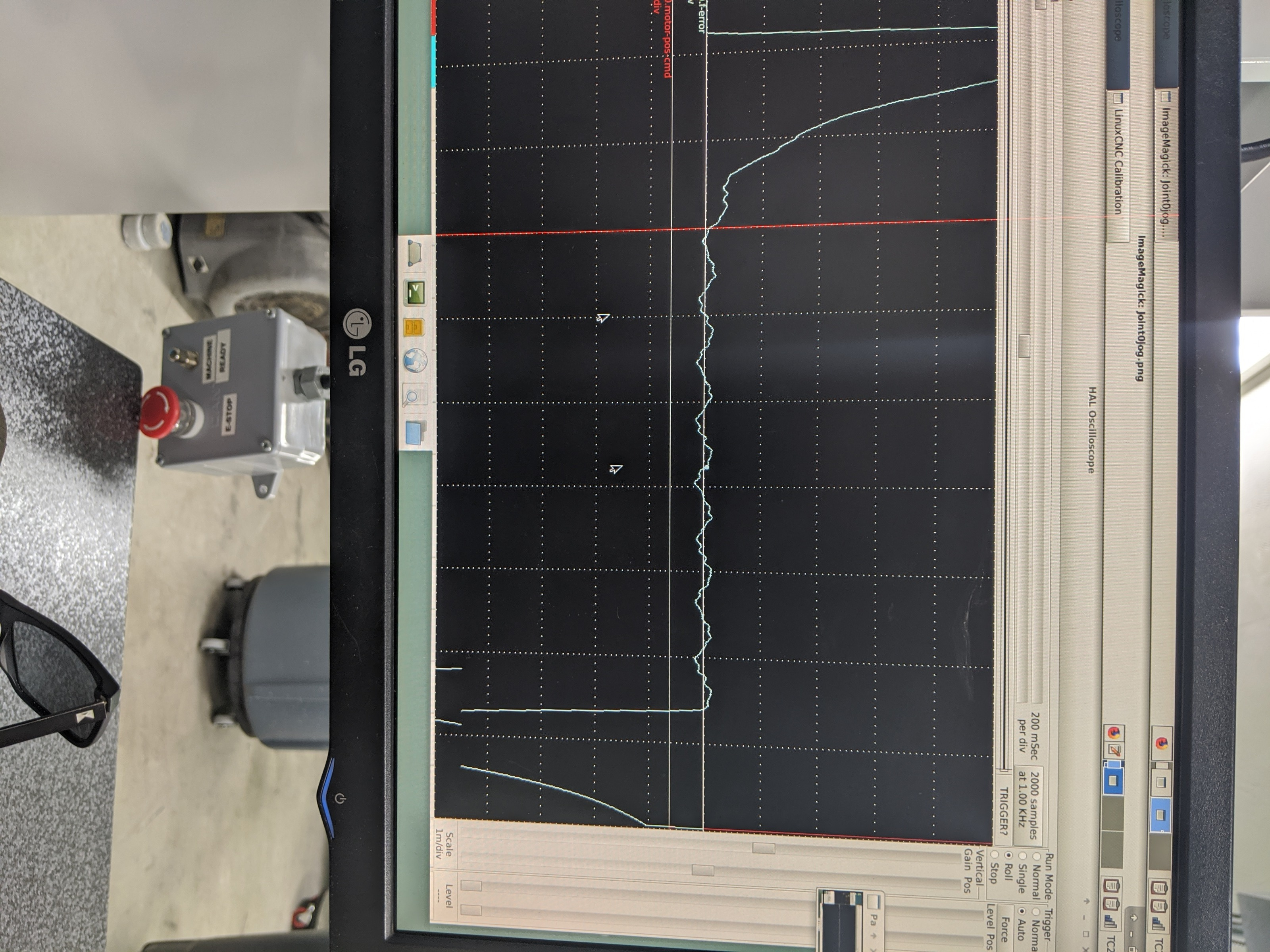

You might try running open loop = pid feedback from stepgen but still feeding the encoders to motions feedback pin
This will give you a measurement of how well the drive itself follows the step/dir position commands
Also you should make sure you have no smoothing filters enabled in the drive

What I am saying is the the stepgens take the joint commanded position and the PID takes the stepgen feedback position (like a non encoder stepgen setup) but you feed the encoder position back to motion
that is:
motion joint position command --> PID command
stepgen feedback position -- >PID feedback
(which is standard open loop stepgen setup)
but
motion joint position feedback <-- encoder position
rather than from stepgen position feedback
This means that any actual following error will be calculated
and can cause a fault
that is:
but

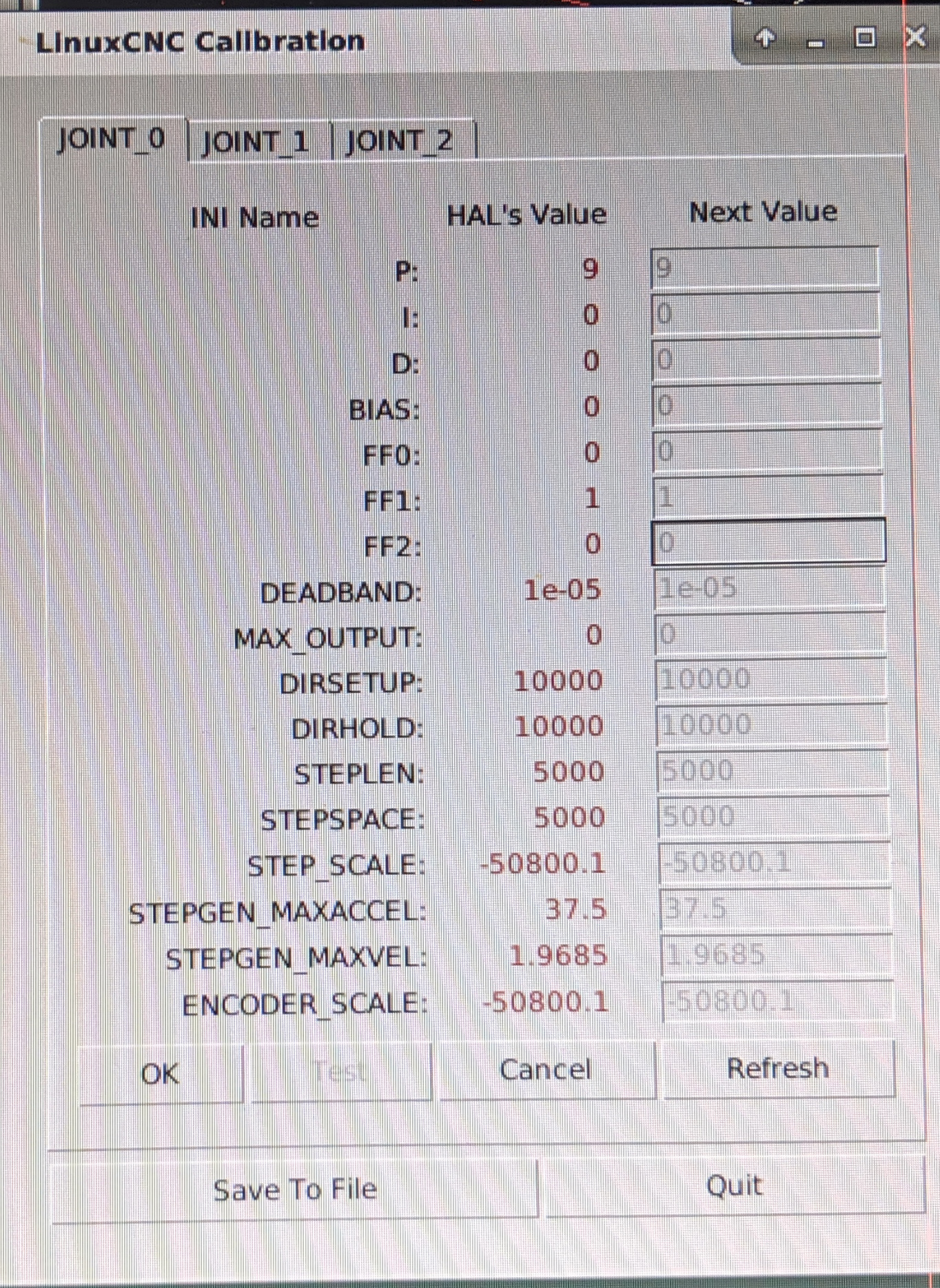

Its been about a year since I have been working on this, life happens.... I spent the evening getting caught up on where i was and I wanted to pick your brain on this.
Here is a quick screen shot of the current scope im getting on joint 0.
Here is a shot of my settings for Joint 0
Based on your last post I know that you were suggesting that I change a few things in my HAL file to try to verify the tune of the actual servo drive. Unfortunately looking through my HAL file i don't find anything that quite matches what you are describing. If its possible that you could take a look at the attached HAL file and copy the lines in that I should change and what to that would be immensely helpful.
I appreciate everyone on heres support and look forward to getting my machine up and running!
