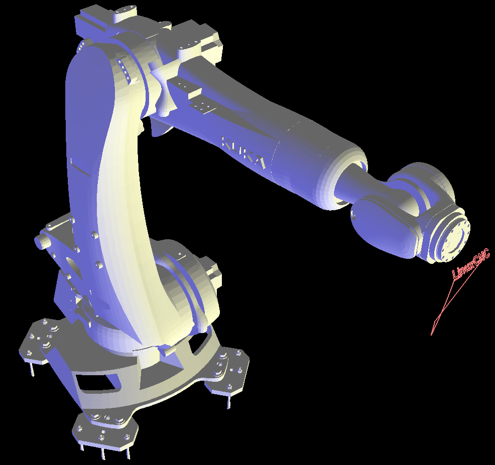

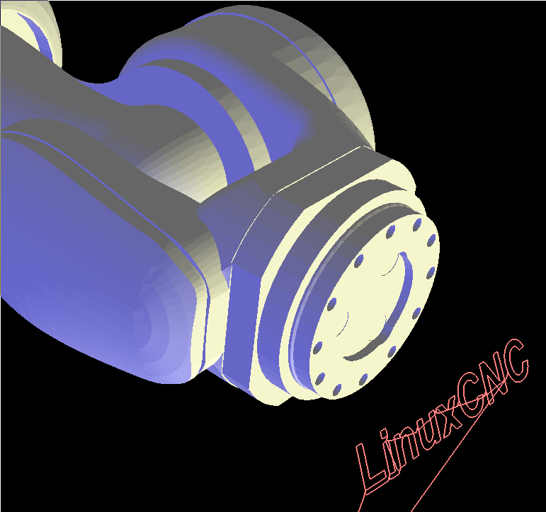

It looks like you and I are near the same spot in working with LInuxCNC. I've got a working Vismach simulation, and am currently working on the kinematics. I have a feeling if I use a long distance linear move, the path will not be a straight line. I will soon have python to go from points/orientations to a1,a2,a3,a4,a5,a6 axis rotations. I'm not sure how to send the axis rotations to LinuxCNC. I could just dump them in there with xyzabc, but I'm not sure that will be right. Even if that is correct, the path from point to point won't be a straight line. I'm sure I could work out the math to send the speeds of each motor at points between the start and end, but again, I'm not sure how to stuff that information into LinuxCNC's kinematics module.
Anyhow, if you would like my Kuka stl models and vismach code, please let me know. I'd be more than happy to send it to you. The cad came directly from Kuka's website, and I used Fusion 360 to export the stl files I used in Vismach. My Vismach code was made by using my head to bash holes in the walls of my house and crying a lot. Anyhow, Vismach seems to work work.

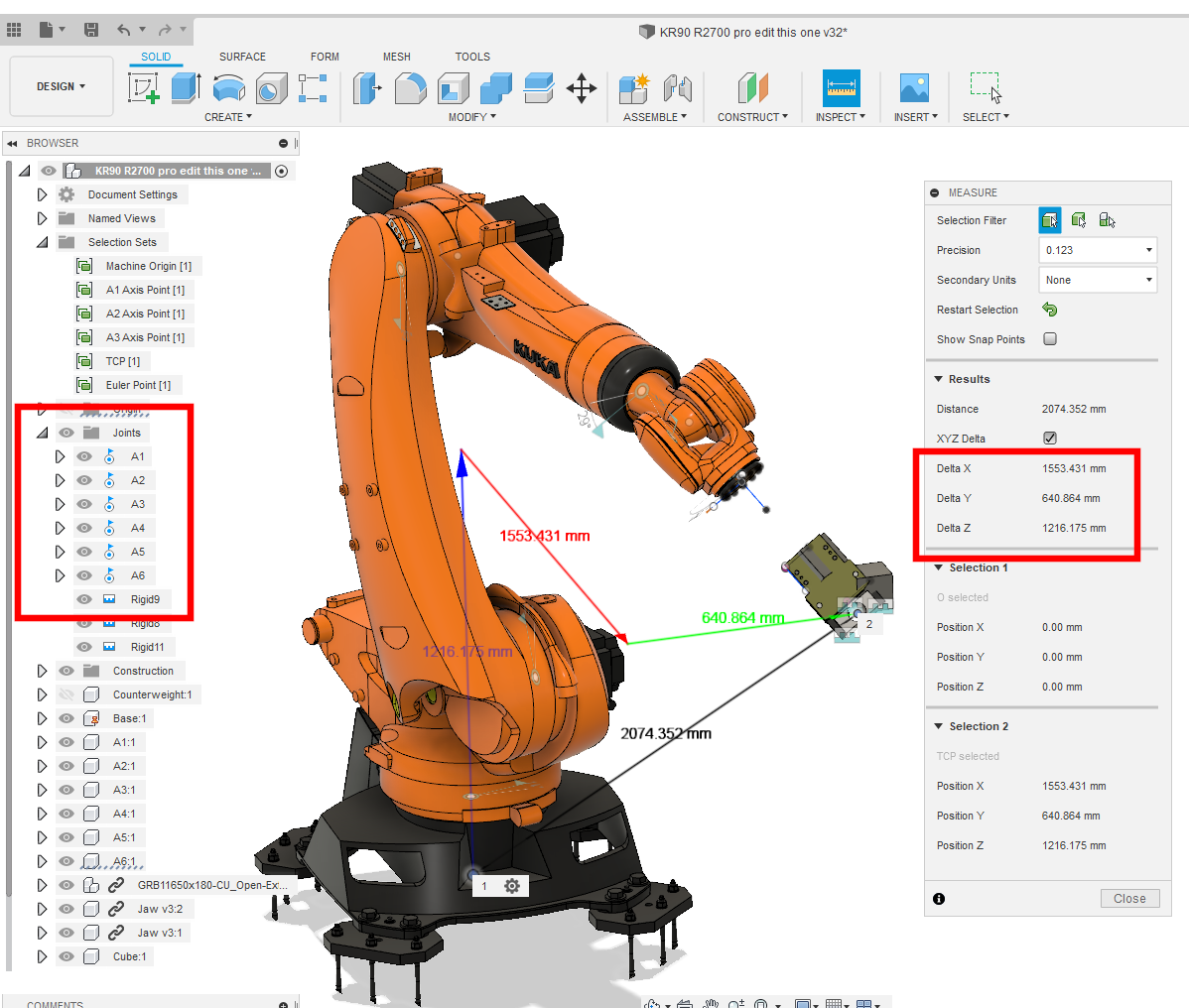

I don't have much experience with Python, so please don't laugh at my coding skills. I used Fusion 360 to figure out the correct answers python needs to give me. In Fusion360, I used revolute joints to define the motion. Then, I could drive joints at specific angles, and measure where the tcp ended up. Also, you can apply joints to the tcp, and then measure the resulting angles of axes to get the answers for the inverse case. I'd really like to talk to someone who codes Fushion, b/c they have all this stuff figured out very, very well. I'm amazed that they let people use Fusion 360 for free. There's a whole lot you can do with it.
Just a quick note. This robot has a Euler wrist, which simplifies the math a great deal. It means axes 4,5 and 6 intersect at one point. I've called this point the Euler point in my code. Also, you need to pick points on the individual axes. Don't just pick any points. If you're clever, you'll notice that, in the mastering position, or when all axes are zero, you will find that points can be chosen such that the points for the machine origin, a1, a2, a3 and the Euler point are all co-planer. This simplifies the inverse a fair amount.
This code is very much under construction. I'm not sure I need to be using numpy arrays, perhaps the regular lists will work. One thing I haven't dealt with is the status and turn selection using bit maps. That's getting a little bit outside of my current mission. If you'd like help with that, I'll help as much as I can.
So, the forward function is the easy case and is straight forward. Call the forward function, and input your angles, and the position from the machine origin to the tcp is the output. I guess I should add more output to describe the orientation of the end effector.
For the inverse, there are 3 inputs. The target x,y,z in relation to the machine origin, and the orientation of the end effector. To specify an orientation, input a unit vectors (actually, I don't think they need to be unit vectors) of the target x and y axes.
So, this is where I am. I have lots of the math, but getting LinuxCNC to understand it seems to be very difficult. The limitation seems to be the G-code interpreter. It needs to pass more to the kinematics module than just xyz. I also need to send xyz for the target x and y orientations. Or, for 5 axis machining, just the one of those vectors. I imagine a kinematics module can be written somewhat similar to the python below. Even in that case, a linear move won't be correct. The kinematic module will need to change the speeds of all the motors to hold the tcp on a straight line path during a G01 move.
