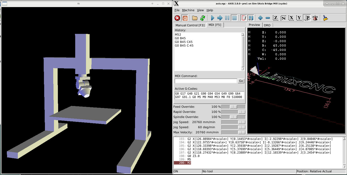

Hi
I work as a research engineer developing a machine that uses 5 axis kinematics the same as a "swivel head" type setup (see video below for an example, though not our machine) and would like to use LinuxCNC to drive it, as it has a great feature set and reputation.
I note that LinuxCNC features a 5 axis kinematics module and that the documentation specifically references swivel table type 5 axis. Please can you advise if the same kinematics module will cover the swivel head type setup as illustrated in the video (often referred to as a B/C head), or if not, whether you are aware of a community written set of kinematics that will cover this type?
Regards
Ross

12 Oct 2019 07:52 #147729
by pl7i92
Replied by pl7i92 on topic 5 axis kinematics modules
the mashine in the video is straight standard so it will fit the standard setup installation
if the mashine is already build you can modifie the kinetics to your need
if you are building it just keep as centerd as posible and you only got the 3 offset parameters
or the 6 if you are not centerd and need generickins

- ross_dev
- Posts: 56
16 Oct 2019 11:12 #147988
by ross_dev
Replied by ross_dev on topic 5 axis kinematics modules
Thank you, as advised it seems the xyzbc kinematics match our needs.
Cheers
RD

- ross_dev
- Posts: 56
23 Oct 2019 10:41 #148593
by ross_dev
Hi Andy
Yes we picked that up the other day, as you say its exactly what we are after.
I noticed that some of the axes freeze when you first start the simulation, and then will eventually start moving. Is this a known issue with that particular vismach script?
Cheers
RD
Cheers
RD

Replied by andypugh on topic 5 axis kinematics modules
It waits for a simulated "spindle at speed" signal. Is that what you are seeing?
- ross_dev
- Posts: 56
29 Oct 2019 13:49 #149048
by ross_dev
Hi Andy
Looks like a rookie error, I had it in joint mode! It works fine once in world mode. Cheers!
