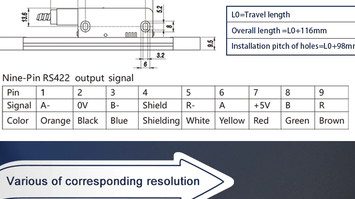

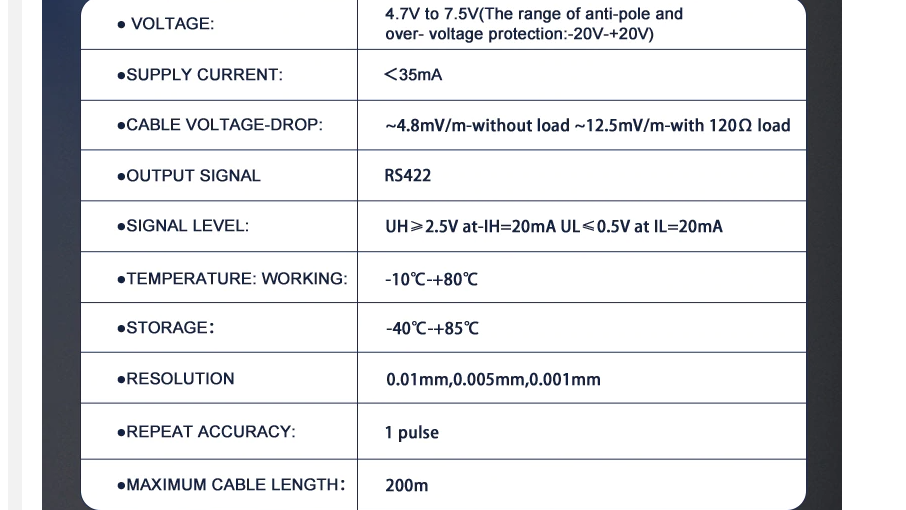

what i have at the moment is a gantry mill build and what i want to do is a dual loop feed back with a linear encoder and some DYN4 DMM servo motors and drives. i have 4 drives and motors and the 4th could very well end up on the spindle for a drive motor. the cables for the scales are not really super long and the longest is 8 meters long.
my question would be around the Mesa boards. i was thinking the 7i76E would be a good fit for my needs but seen that a 7i76ED also sold. the interface for the encoders would need another Mesa board and i'm not sure which combination would be best to use with the DMM motors and drives? 7i85 or a 7i85S ? which combination of these would work best with the DMM motors and drives?
the linear scales and readers use RS422 from what i gathered. but here is a picture of the specs for those just to keep things clear.
