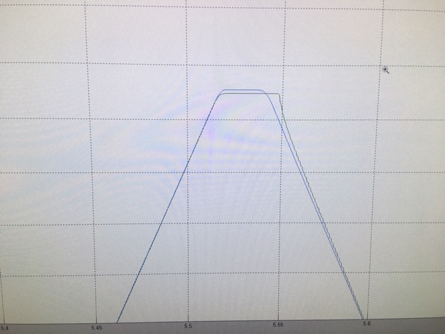

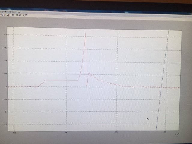

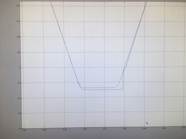

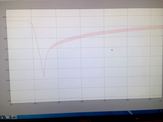

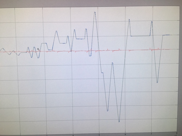

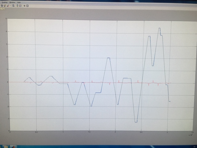

13 Oct 2020 21:42 - 13 Oct 2020 21:47 #186023
by boksi
Replied by boksi on topic How Linuxcnc is compensating backlash?
Thanks for info. I think that thrust bearings are ok as whole axis was taken apart and buld up again and checked. For now I tried turning in one direction with hand wheel then stop and pushed whole table into same direction. Quite a lot of force applied and it has moved. Start again turning hand wheel in same direction and it was loose as it needs to catch up with new position. Scale on hand wheel is in mm so I roughly measured backlash it is about 0.8mm until table starts moving and dial indicator showed that.
I am not currently working on this axis. I am working on axis which carries a lot more weight and couldn’t make same testing ( also this axis was taken apart and build up again so thrust bearings should be ok). Backlash here was measured with reading hand wheel and indicator while changing direction.
Concerning dual loop I posted results in post above here are some pictures of reference, output and error.
For inner loop I am using tacho.
Have to do a lot more concerning tuning but for now get a sense that glass scale is working “better” then dual loop with glass scale and tacho. Think this is due a lot of nonlinear friction so could not get high gains in inner speed loop so it is rather loose.
Here are plots glass scale + tacho (dual loop). Y axis is in mm x is in some time increment.
Here are plots closed loop with just glass scale.
