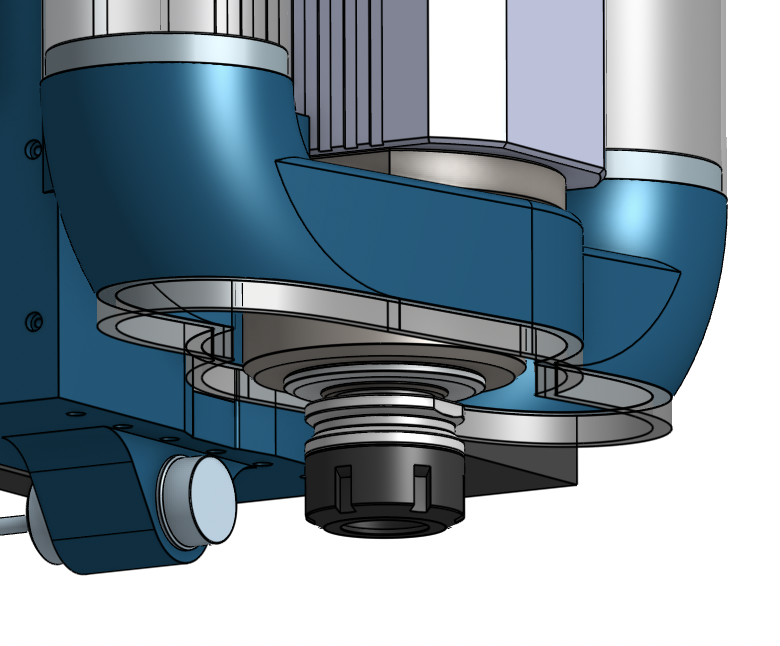

I love Marius's channel and would like to replicate his
dust collection shoe

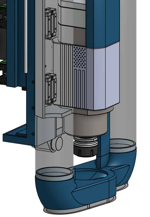

. It has a "Z axis" that is independent of the tool's Z axis movement, enabling finer control of the dust collection and air nozzle placement. However, in my design the dust shoe "Z axis" isn't referenced from the gantry, but from the tool plate itself.
I have attached two views of my dust shoe (with two tubes) and spindle with collet (no tool). One with the dust shoe extended, and one with it retracted for changing tools.
I have a homing reference switch on the dust shoe axis as well as the Z axis. When the dust shoe is fully retracted and Z is fully retracted (moved up) I know the distance from the bottom of the dust shoe to the top of the workpiece. My question is, what is the best way of controlling the dust shoe axis independently? My thought has been to add another real time thread that controls the dust shoe, but this thread would also need to have constant knowledge of the “raw Z value” (which I think is Z value in machine coordinates?) as well as the state of program (eg. cutting, or changing tools).
Another idea I had was to add some extra post processing of the gcode, but I feel much less comfortable with gcode (and understanding the various caveats/intricacies) than I do with multithreaded C/C++. My worry (with this latter idea) is that I miss what coordinate system is being used and muck up the correct dust shoe height. More importantly, it feels cleaner to not have to mess with the gcode for controlling dust collection.
Thanks in advance!

I think that you can do this in HAL. If you choose the W axis to control the shoe, then connect the motor position command to joint.8.motor-pos-cmd - joint.2.motor-pos-cmd
(You could also do it in a kinematics module, but that might be a little overdoing it)
To subtract one number from another in HAL you use the "sum2" component with a negative gain for one input.

Actually, with LinuxCNC 2.8 you would generally configure Axis W to be Joint 4. (It had to be joint.8 in 2.7 and earlier.I think that you can do this in HAL. If you choose the W axis to control the shoe, then connect the motor position command to joint.8.motor-pos-cmd - joint.2.motor-pos-cmd

Looking at the HAL solution further, would that not fix the W axis to always be dependent on the Z axis?
I don't always want the dust shoe to be extended fully, such as when changing tools it needs to be retracted, or moving rapidly I'd want to pull it off the work piece slightly more.
Could I create something conditional in HALTCL? Also, what's a good way to "know" from LinuxCNC when the CNC is cutting? I was considering remapping M7.
Finn
Finn

15 Apr 2023 08:56 #269075
Replied by andypugh on topic Dust Collection Shoe with independent Z control
(Catching up)
Yes, my solution would leave the shoe hovering a fixed distance above the table, whilst the Z moved about. Which would be fun to watch, at least.
As you have surmised, you could use a MUX to switch that axis between W control and a fixed position. Maybe it would make sense to use the vacuum-on signal to switch the behaviour.
You don't need to re-map the M7 / M8 signals, you can just use them as-is and repurpose the HAL pins iocontrol.0.coolant-flood / coolant-mist.
You probably need a bit of extra logic so that the shoe-axis homes properly. I think I would do that by adding extra select bits to the mux.
ie
sel-0 = coolant
sel-1 = W-homing
Then connect inputs 1,2,3 to the PID and 0 to a fixed retract position.
Note that you probably want to disable the PID when it is not in use and you will have to "lie" to LinuxCNC about the W-joint position feedback to avoid following-errors. I would just short-circuit the motor-pos-cmd to motor-pos-fb and leave LinuxCNC unaware of what the shoe s doing.
ie
sel-0 = coolant
sel-1 = W-homing
