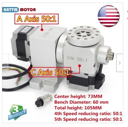

Hello folks,
I'm new to LinuxCNC, but I have a lot of CNC experience, 3 axis or less (lathe). I have built my own CNC machines, but mostly using grbl controller on arduino. I'm very intrigued by LinuxCNC and want to add A and C axis to one of my CNC routers. I'll build a LinuxCNC machine on a RPi or something with a little more horse power. I have a Mesa 7i76e card. I want to do simultaneous (TCP kinematics?) machining.
So, now for questions:
1. Can I output from Fusion 360 CAM for LinuxCNC TCP (my vastly preferred creation tool)? If so, is there a post processor ready to go for this. I see a Linux EMC and EMC2 PP in Fusion 360, but there are no details listed regarding continuous 5 axis, etc. Has anyone done this successfully?
2. Is the 7i76e Mesa card an appropriate controller for simultaneous 5 axis?
3. How difficult is it to install and configure TCP/kinematics for this setup? I'm not a programmer, but do understand editing configuration files, etc. Is there sufficient documentation?
4. Is there anyone out there using this configuration willing to help me if I get stuck?
5. I've seen a few videos of this working on youtube, but there isn't a lot of support documentation for setting the configuration files, etc. Maybe I just haven't found it? If you know a good repository of this knowledge, please share.
These are my questions so for before I take the $570 plunge and purchase a harmonic drive (zero backlash?) AC unit.
I want to become a penguin adopter and look forward to a more editable and powerful software interface. I'm hoping to make this work! Any help would be greatly appreciated. I'm happy to create videos documenting this process for future 5 axis peeps.

Thanks so much Aciera!
I know the rigidity/holding power of these cheap harmonic drive AC tables is not stellar, but I will be cutting fairly soft material, so I'm not entirely concerned. They have little backlash and repeatability seems to be decent based on a few tests I've seen on YouTube. Plus, it's a USA shipper who has already agreed to honor a return if I deem the backlash to be too excessive for my purposes. I have also looked at the belt driven versions of AC tables, (ratio 6:1 and 8:1) and I may go that route as I'm more familiar with belt drives than harmonic drives.
I appreciate the offer to help me through the LinuxCNC setup. I'm fairly computer savvy and am very familiar with editing .ini files to change configuration, etc. What I don't know much about are the LinuxCNC plugins (?) like the kinematics, which allows TCP. And I'll have to learn the LinuxCNC nomenclature, axis are referred to as "joints," for example.
I've also learned that true 5th axis continuous tool paths CAM abilities in Fusion comes as a paid extension (add on), which runs a very steep $1200 or so a year to use. Ug!
Does anyone know of a reasonably priced 5 continuous axis CAM software that I can import a mesh object into and create both CAM and post processing which LinuxCNC will happily ingest?
Phew, it's a lot. Thanks for humoring me as I dip my toe into both the 5 axis continuous world, LinuxCNC world and I'm sure there's something else!

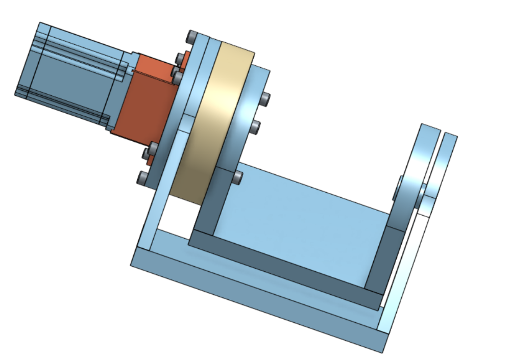

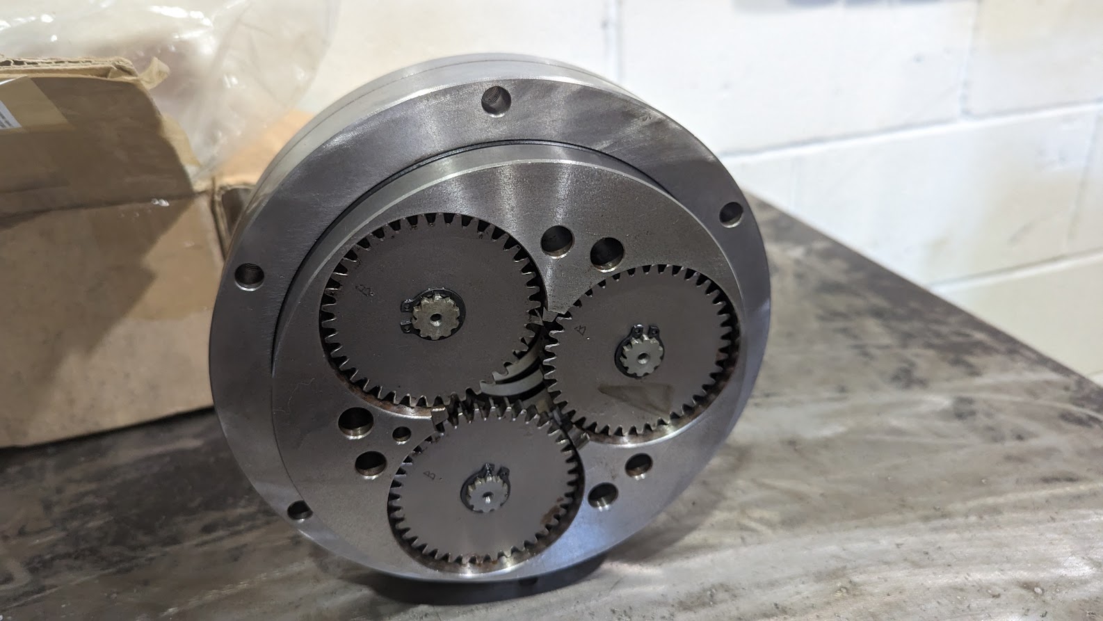

I have no experience with 5 axis. Aceira is the expert with the kinematics mathematics. I have enough trouble moving from 2D plasma cutting to a 3 Axis CNC Mill I converted. But 2.9/2.10 have some really nice kinematics modules using a method called switchkins which allows swapping between conventional 5 axis cnc mode and 5 axis TCP mode which is cool...
But somebody gave me a High precision rotary gearbox recently. Fortunately, I have a good gear shop who has been making parts for me for years so they are making the missing input shaft (The manufacturer had full specs.) And I have done a bit of work in Onshape. I was planning on using flat parts laser cut from 16mm or 25mm steel. Then bolt or weld together. Welding would require normalisation and machining...
Its not really a trivial project. This baby needs a 6000 rpm 1 kW servo motor to output 40 rpm. I think that is in the ballpark. What do you think/

Looks like you've got a very beefy cycloidal drive there! It seems a bit overkill unless you're trying to mill steel on a regular basic. I plan on starting with a somewhat inexpensive AC setup, around $600, and learn my way around 5 axis machining using very forgiving materials. I'm really curious how accurate I can get. With 3 axis machining, belt driven, I'm living in the ±0.05mm accuracy range. I'd love to be able to achieve this in 5 axis continuous land without breaking the bank, but I don't know how realistic it is.
Good luck with your project. You can't find a replacement shaft from the manufacturer of that gear box?
