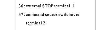

27 Aug 2023 08:41 #279080
by chris@cnc
Maybe you could wire a relay. Signal Spindle enable switch the traget 0-10V or S4 if spindle stop.
Replied by chris@cnc on topic Unable to stop the spindle fully, stutters (mesa 7i96/7i76 ->Folinn Bd600 0-10v)
I take a look in the manual and spindle stop is if you set S4 on F05.3 -> 36 (external Stop terminal 1).I tested adding a manual signal on the VFD with pin S4 toggle switch to ground.
Here's the behavior on S4 with different settings on F05.03
-37 (stop) = nothing
-47 (emergency stop) = desired behavior - stops the stutter and oscillating of FWD/REV LED's similar to hitting the stop button on the VFD
-7 (Fault reset) = nothing

27 Aug 2023 11:12 #279086
by camb0
Replied by camb0 on topic Unable to stop the spindle fully, stutters (mesa 7i96/7i76 ->Folinn Bd600 0-10v)
Hi Chris, Thx for the suggestion.
I tested it earlier today and value 37 doesn't do anything, however 47 does.
So I could use the signal, however I thought about using it (perhaps with a relay) however the issue is that I would need to trigger S4 on stop for a short period of time otherwise any subsequent commands won't work. That period of time will be dependent on when the spindle braking is finished ... so I could trigger it after say 1 second for a duration of 0.5s. Not sure if I need a special relay for that or if I can use a Hal function.
Not impossible to do but a bit more work is needed.
- chris@cnc
- Posts: 529
- Thank you received: 140
27 Aug 2023 12:05 - 27 Aug 2023 12:07 #279089
by chris@cnc
That's right, 37 do nothing. It should be 36
