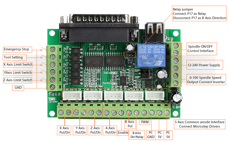

Hi all, I've read what similar threads I could find on the 7i96, but couldn't get sufficiently confident (and those were mostly related to making PWM work) - can I connect the ubiquitous Chinese breakout board to a 7i96s P1 port without issue? Hopefully without changing the bitfile - I'm only after additional basic IO, primarily the inputs.
I think the inputs are NPN style and commoned to the 12-24v breakout board power input, but not sure if that's isolated from the parallel port - if anyone knows if it's safe please confirm/deny! I don't have the board yet.

The pinout for P1 is given on Page 7 of the manual:
www.mesanet.com/pdf/parallel/7i96sman.pdf
It does appear to be a standard parallel port pinout, except that all non-GND pins are bidirectional.
Depending on the firmware flashed on the 7i96 you might need to limit some functions in order to have their associated pins become available as outputs.
And you will also need to set up the input / output direction to match the hardwired directions of the BoB.
Which firmware are you using?

It looks like all pins on P1 (IO 34-50) are unallocated in your firmware, so it should be straightforward to use the BoB.

05 Jan 2024 15:45 #289875 by PCW
Replied by PCW on topic 7i96s + Chinese BOB on P1
7I84Ds are available and Mesa should have 7I84s in a few weeks
You can use 7i96s_5abobd firmware if you want additional step/dir
outputs or PWM/Analog on the Mach3 BOB
