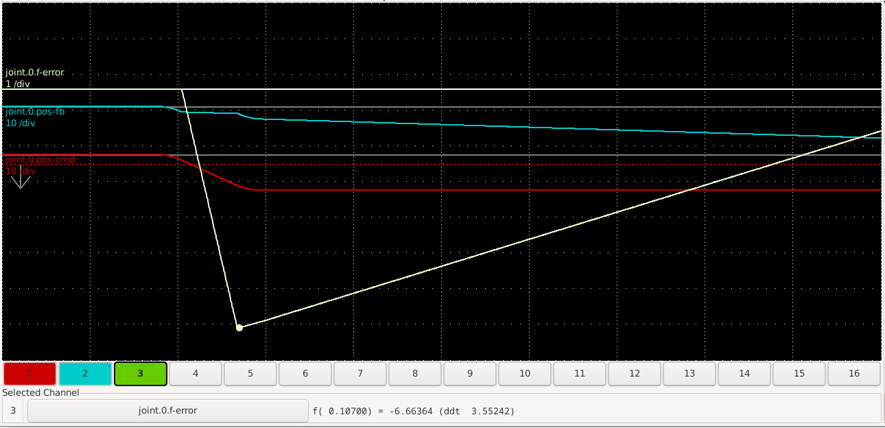

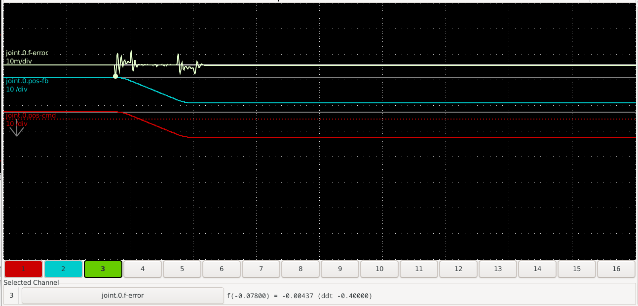

according to JT the correct way to configure Mesa 7i95t (step/dir) is using velocity mode with feedback from servos. This involves tuning PID loop for velocity mode. I am using Delta B3L 400W servos with step/dir interface.
I succeeded in tuning PID to sufficient error with peaks at ~0.005mm at 12000mm/min and 1000mm/s^2 accels. This was done at 1000steps/mm stepping rate and the encoder scaled to same 1000pulses/rev. I decided to increase the stepping rate and encoder to 10000steps(pulses)/mm.
This is where I get issues: At maximum velocity 3000mm/min everyhing looks fine:
however if I increased jog velocity to 3300mm/min this happened:
I am suspicious, that this has to do with encoder read rate of Mesa 7i95t.

But according to my calculations I should be fine with speeds up to 300mm/s (10000*300=3 000 000).
I also noticed, that at rate 3300mm/min the 10mm jog resulted into ~17mm jog on the machine.
at 3000mm/min the 10mm jog was perfectly accurate.

17 May 2024 13:55 #300832 by PCW
Replied by PCW on topic Mesa 7i95T PID tuning for velocity mode
Did you try turning off the encoder filter?
The following user(s) said Thank You: zmrdko

17 May 2024 19:17 #300855 by zmrdko
Replied by zmrdko on topic Mesa 7i95T PID tuning for velocity mode
I don’t know how, but it worked.
I have learned from manual, that encoder filter = 1 requires 15 encoders counts to start counting. 0 makes it 3 encoder counts. But I don’t see how that impacts my issue.
17 May 2024 19:28 #300858 by PCW
Those are not encoder counts but rather sample clock counts of the encoder digital input filter
on the A,B,IDX pins. If the time (15*sample_clock_period if filter is true and 3*sample_clock_period
if filter is false) is greater than  the width of the A or B signals, the inputs will not be recognized
