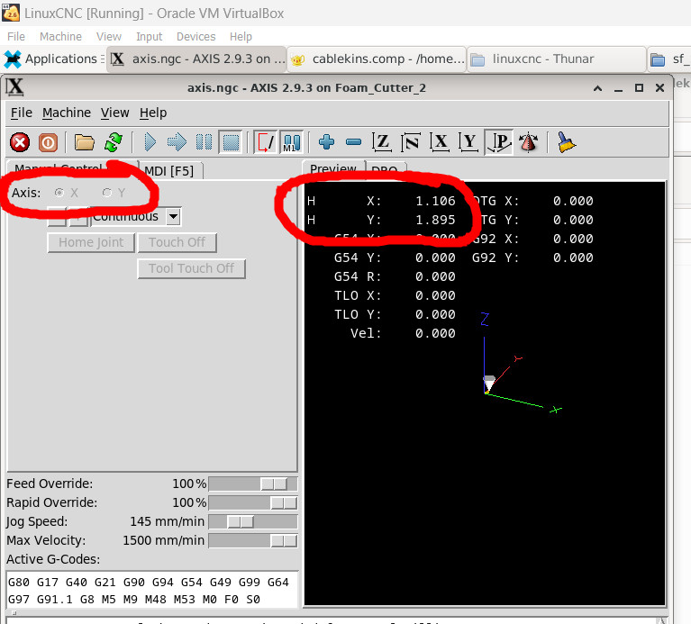

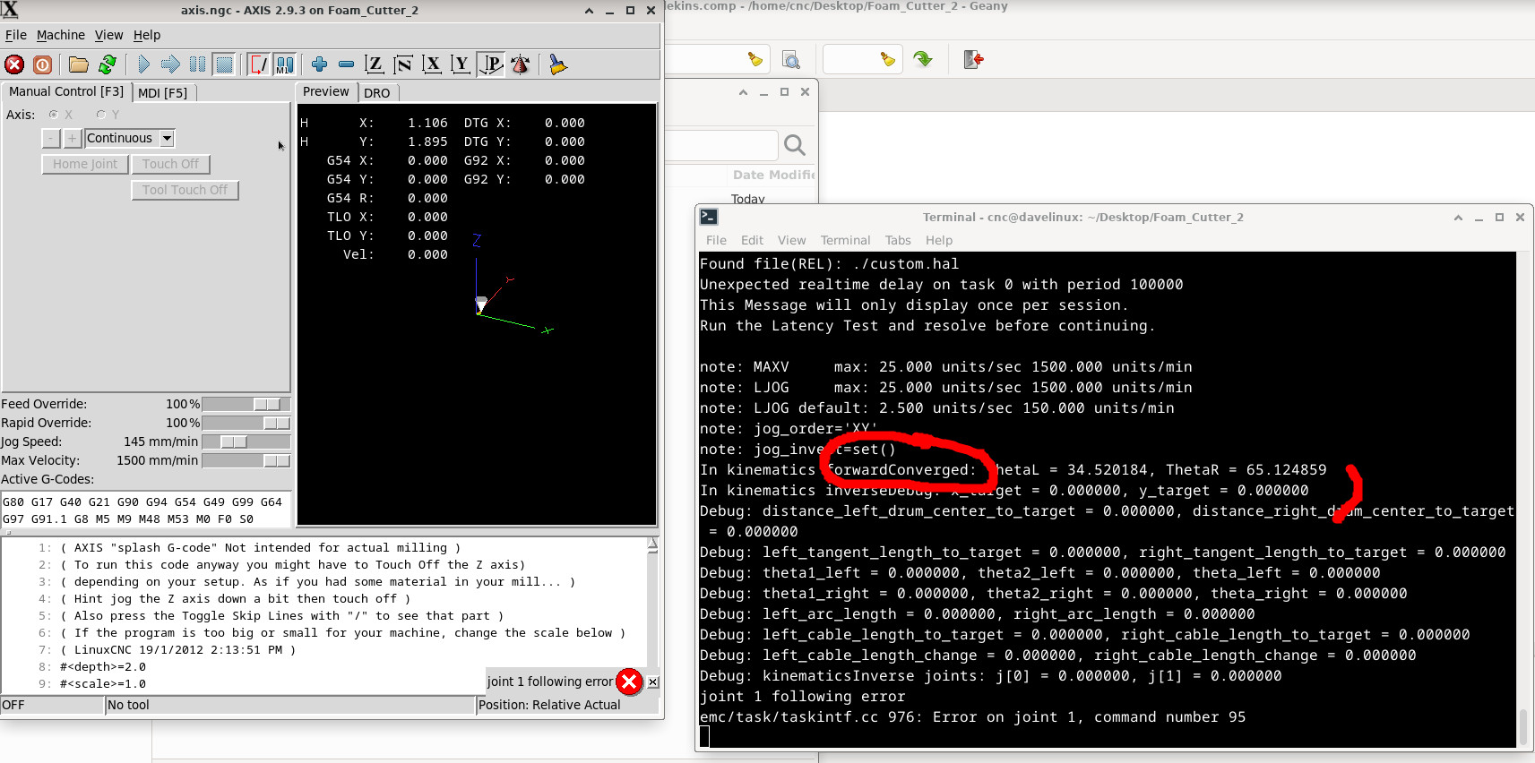

Thanks for the comments - they were very useful.  Here is what is happening when I try running LinuxCNC with my custom kinematics.
I am running in simulation mode - no hardware is connected or moving

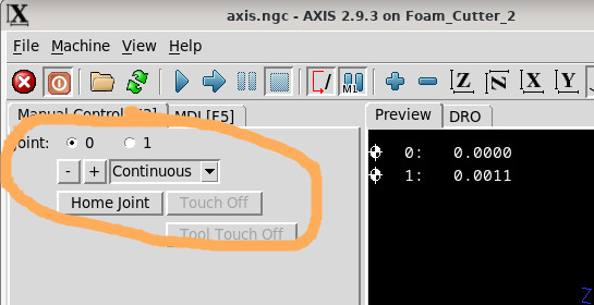

When I launch LinuxCNC, the GUI only lists Joint0 and Joint[1]  - not X and Y (1st image)
When I "home" the machine, X and Y appear on the GUI however the position of the unit jumps to x1.106, y1.895 (image 2)
At the same time, the forward kinematics are executing and coverging, but not exactly where I expected them (very close though)
Am then getting a "Joint Following Error" and the inverse kinematics are executing but returning zeros for every calculation.
My cablekins.comp file is attached.

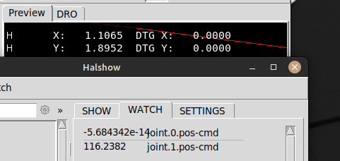

29 Sep 2024 11:48 #311020 by Aciera
Replied by Aciera on topic Struggling with custom kinematics...
I'm afraid I don't have time to debug your kinematic model but it looks like your forward and your inverse kinematic models are not 'inverse' to one another and so a joint position of 0/0 (ie after homing) does not result in a cartesian position of X0/Y0 and vice versa as it should.
Note how the Joint1 position has run away after homing:
I'm not really familiar with using Jacobian matrices but I would have expected the forward kinematics to use the jacobian matrix and then invert that to derive the inverse kinematics. You seem to use the jacobian for the forward kinematics only.

So to give you a clear idea of my understanding of how things work.
1. before homing the controller is in 'joint' mode and axes (eg X,Y,Z,...) do not exist
2. a successful homing procedure ends with the joints being in a known position (ie each joint position is either zero or offset by the OFFSET or HOME_OFFSET values set in the [JOINT_n] section of your ini file or has a known position from an absolute encoder)
3. these joint position values are then passed to the Forward kinematic model which calculates the initial values for the axes position.
4. Axes are created as setup in the ini file (eg X, Y, Z) and are initialized with the values calculated in step 3
5. The trajectory planner calculates the axis positions and passes them on to the Inverse kinematic model which calculates the joint position values to be passed on to the motor drives (eg by way of step generators, ethercat command, analog voltage, etc).

OK, I found an embarassing math mistake that has fixed my forward transformation. But I'm pretty mystified by my inverse tranformation. All of my constants appear be being set to zero.
For example, in the following cablekins.comp file I have defined:
const double LEFT_DRUM_X = -100.0;
const double LEFT_DRUM_Y = 250.0;
These are being used in the forward transformation and working properly.  However in the inverse transformation i put in print statements:
debugPrint("Debug:     LEFT_DRUM_X = %f, LEFT_DRUM_Y = %f\n", LEFT_DRUM_X , LEFT_DRUM_Y);
and the output is:
Debug:     LEFT_DRUM_X = 0.000000, LEFT_DRUM_Y = 0.000000
Sorry my C sucks.. any idea why this is going on?

04 Oct 2024 06:12 - 04 Oct 2024 06:17 #311267 by Aciera
Try with
rtapi_print(
instead of
debugPrint(
[edit]
with the above I get this output:
In kinematics inverse
Debug: x_target = 0.000598, y_target = 0.000315
Debug: 	LEFT_DRUM_X = -100.000000, LEFT_DRUM_Y = 250.000000
Debug: distance_left_drum_center_to_target = 269.258170, distance_right_drum_center_to_target = 471.698383
Debug: left_tangent_length_to_target = 263.433105, right_tangent_length_to_target = 468.397698
Debug: theta1_left = 0.380509, theta2_left = 0.208385, theta_left = 0.588894
Debug: theta1_right = -1.012197, theta2_right = 0.118369, theta_right = -0.893828
Debug: left_arc_length = 32.803895, right_arc_length = -49.789988
Debug: left_cable_length_to_target = 296.237000, right_cable_length_to_target = 418.607709
Debug: left_cable_length_change = 0.000000, right_cable_length_change = 112.767291
Debug: kinematicsInverse joints: j[0] = 0.000000, j[1] = 112.767291
