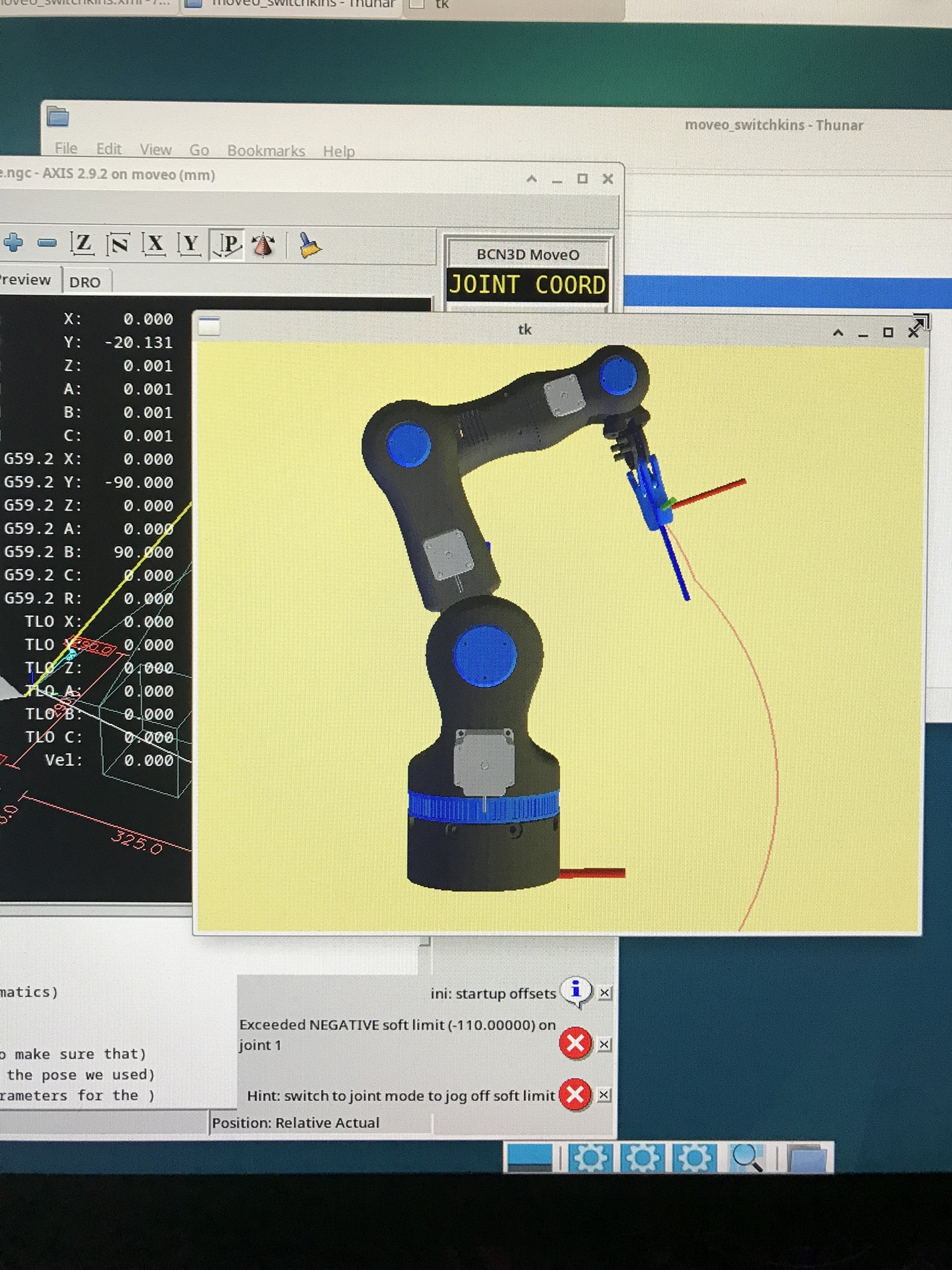

I have a hobby robot partly based on the Melfa sim.  When I home the robot all axis report zero degrees.  The Cartesian location appears correct and it jogs correctly in world/Cartesian. The problem is I'm getting axis limits that contradict what is reported at the Home position pictured below.
With axis 2 limit set to -45/+110 I'm getting a error at -20 degrees.  It appears the axis limits are rotated 90 degress some how.  Is there an absolute vs. relative setting?
I could fudge the limit settings but I want it done right.  How should I define the axis limits?

Replied by Aciera on topic 6DOF robot Limit Issues
You have a work offset of -90 set for Y (joint1) so your position is actually indeed -110.

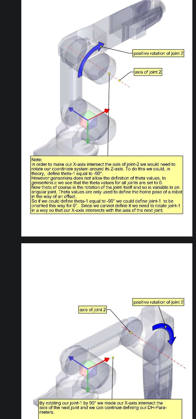

15 Oct 2024 08:33 - 15 Oct 2024 08:44 #312133 by Aciera
You don't _need_ it, those are simply used to define the pose for (x,y,z,a,b,c)=(0,0,0,0,0,0).
[edit]
Actually I just noticed that you are not getting an 'axis' limit error but a 'joint' limit error. So the issue is that you have to adjust your 'MIN_LIMIT' , 'MAX_LIMIT' values in the [JOINT_1] section of your ini file. Note that joint1=0 has the upper arm in the horizontal forward pose as that is what is used in the genserkins model so you may need to adjust the limit values accordingly.
www.linuxcnc.org/docs/2.9/html/sv/motion/dh-parameters.html
Last edit: 15 Oct 2024 08:44 by Aciera.

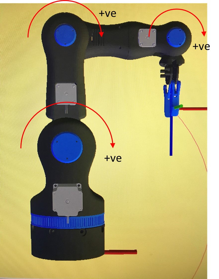

So the joint axis limits in this case are relative the arm posture defined by the modified DH parameters?
Last edit: 15 Oct 2024 22:27 by Project_Hopeless.
16 Oct 2024 07:31 #312223 by Aciera
Yes
You can watch the current commanded joint position in the 'halshow' tool under:
'joint.N.motor-pos-cmd'
Where 'N' denotes the joint number (ie 1 for the joint in question).
