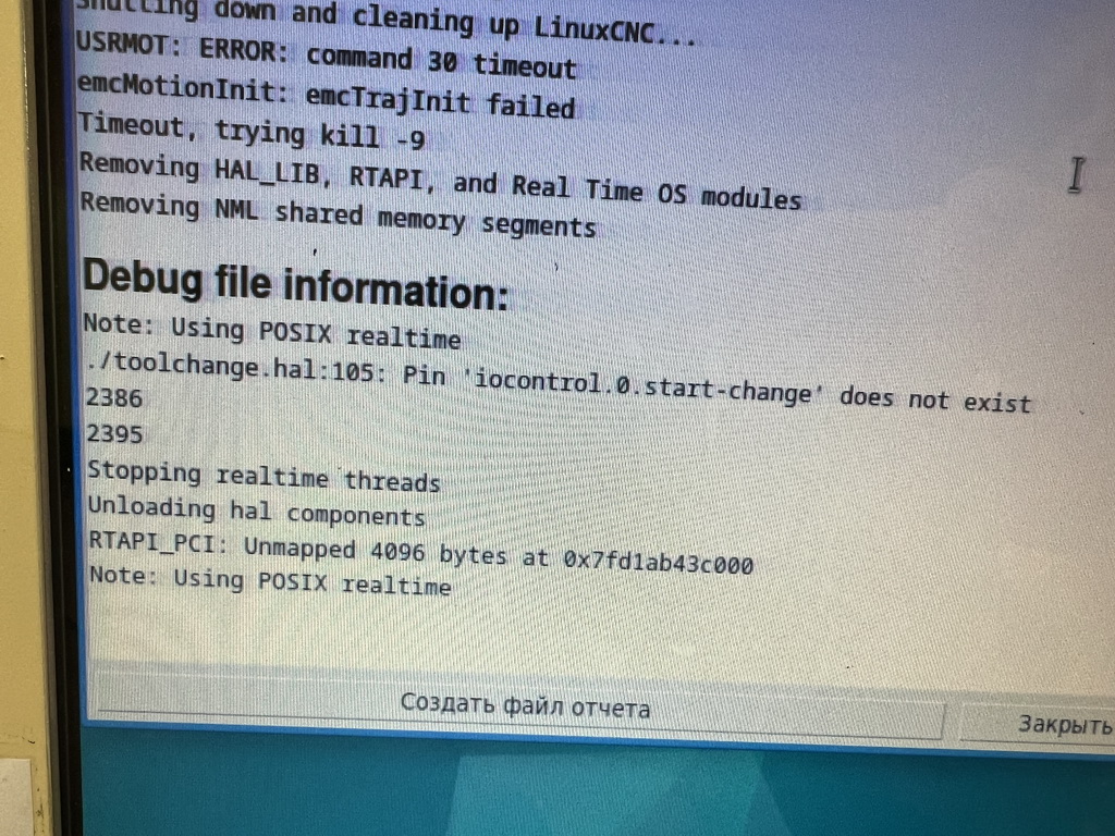

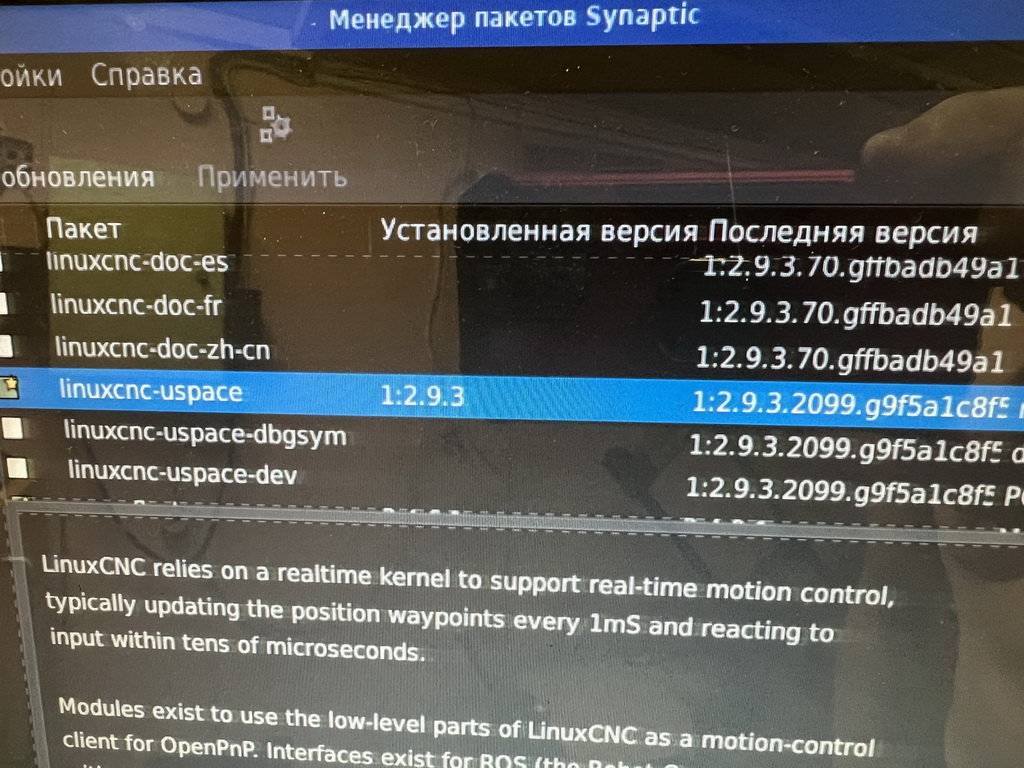

No iov2 pins are available in the latest update, everything works when rolling back to release 2.9.3. What's the reason?

As I understand it, 'iocontrolv2' has been removed in master:
github.com/LinuxCNC/linuxcnc/pull/2497
Using a remap seems to be the suggested alternative.

15 Oct 2024 22:46 #312207
by Serg452
Replied by Serg452 on topic iov2
linuxcnc.org/docs/html/
If someone updates the text of the documentation, then in 2.9.3-2099 everything is unchanged in iocontrol-v2
linuxcnc.org/docs/html/config/iov2.html
