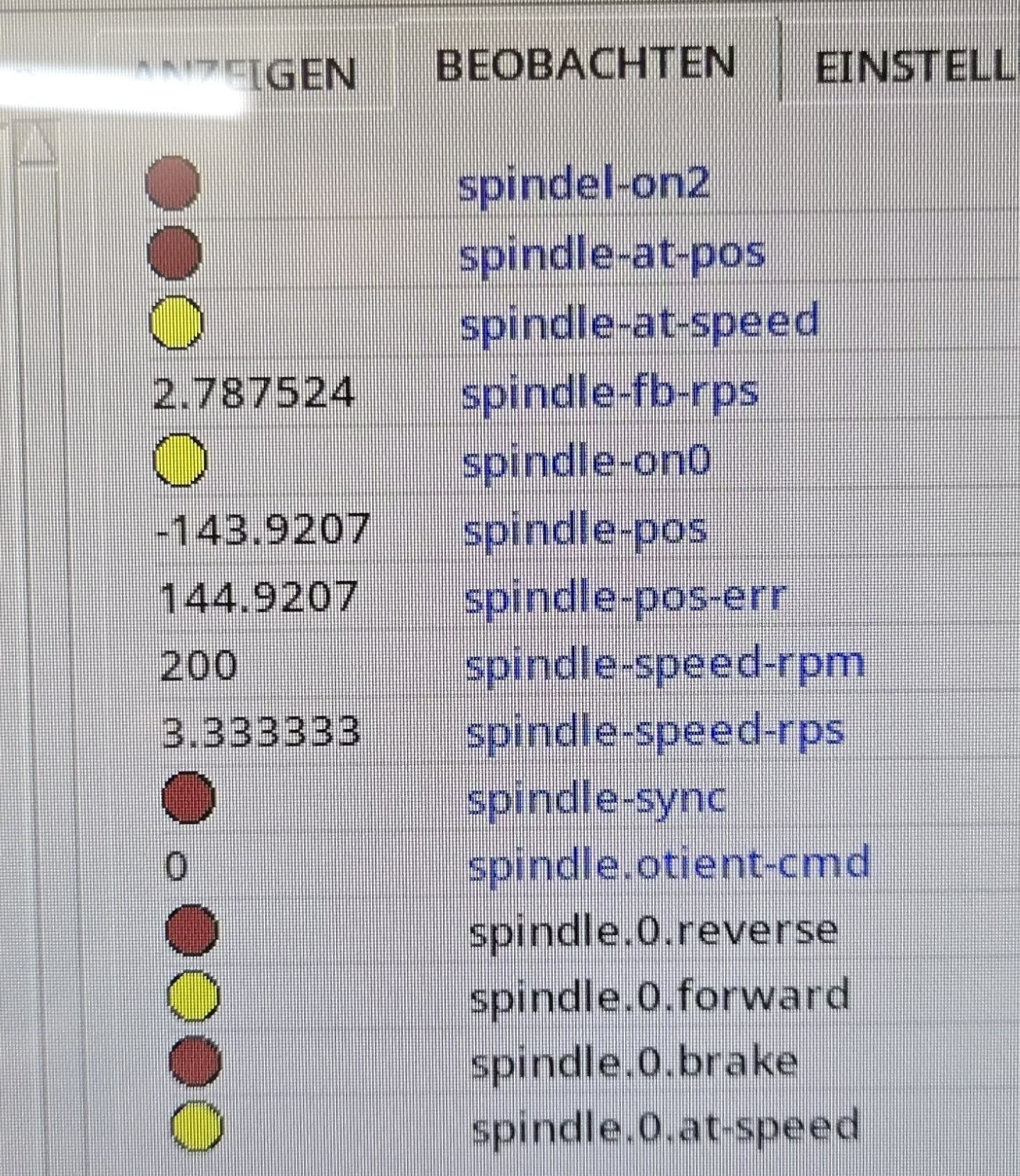

Hello People,i have a 3,7kw Servo from szgh that i would like to use as my Spindle Servo via step/dir(external pulse control).
To be more precise i am using a original Mesa 7i95 and the SZGH Servo is SZGH09-2-24-3,7/5,5-4-1500 with a max speed of 15000 rpm.
I can send the manual for the spindle servo if s1 feels very motivated to read that.
I am a novice with linuxcnc but i watched a video from talla83 and suprisingly got the spindle to turn. I am able to adjust speeds/direction with the according commands.
There is some stuff that does not work.
First vmc_2.halof all using M3 turns the spindle ccw and m4 turns it cw. It should be the other way around. I checked the wiring first and everything seems to be correct as seen in the table for the encoder.

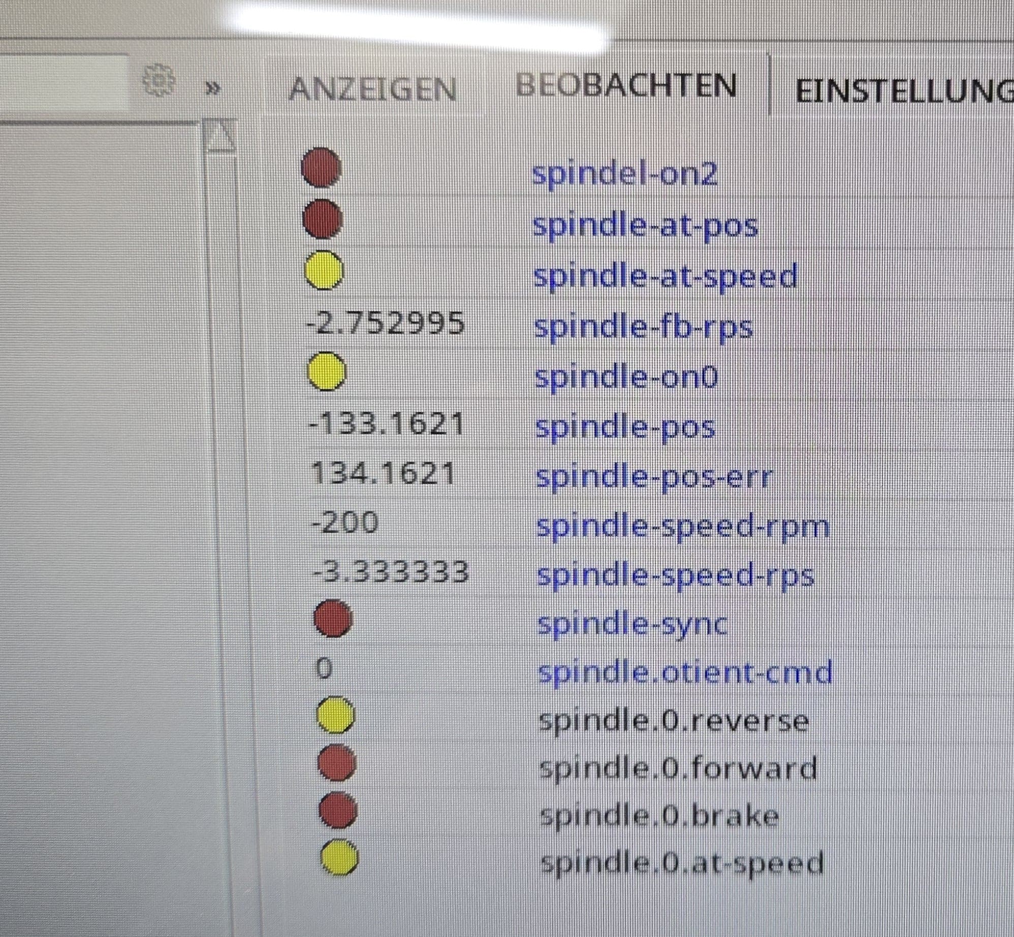

I also checked if the step/dir was correct and it is(polarity too).
If i run the spindle via mdi M3 s200 i get this in halshow (attached picture M3 S200 with positive rps)
If i run the spindle via mdi M4 S200 i get this in halshow (attached picture M4S200 with negative rps)
What i also noticed in Halshow is that whenever i command the rpm to go over 300 the spindle at speed signal does not go true anymore.
I really hope someone can help me here or give me some tipps, i have checked and tried many things but nothing really helped.

Sounds like either the encoder scale or the step/dir scale (or both) are wrong.

Hello PCW,
thank you for the fast answer.
I checked the parameter of the servo with the manufacturer and he told me that the motor resolution per revolution is 1024 which is then *4 4096.
4096/60 = 68.26667 = pulse per second.
How does a wrong scale invert the direction for m3/m4?

So, add a - to scale
Or
Invert the direction pin in hal.
Replied by tommylight on topic Spindle servo step/dir Problems
It does not, uless a - sign is in front of it.How does a wrong scale invert the direction for m3/m4?
Or

You need to reverse the sign of the step scale (or invert the direction output)
to reverse the spindle

Its this (in the ini file)
OUTPUT_SCALE = 68.26667

i did invert it to:
OUTPUT_SCALE = -68.26667
and now the spindle turns correct.
The Problem with the difference between spindle-fb-rps and spindle-speed-rps still persists tho. spindle-fb-rps is negative and spindle-speed-rps is positive (in case of m3).
This lead to spindle-at-speed never beeing true.
Edit: even when i invert the encoder scale the difference btw. the fb rps and speed rps(commanded) is too big for spindle at speed to be true.
