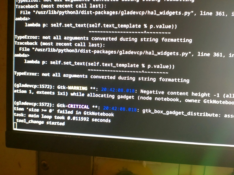

Ok so what I did and what whas the result is shown in 2 pictures attached.

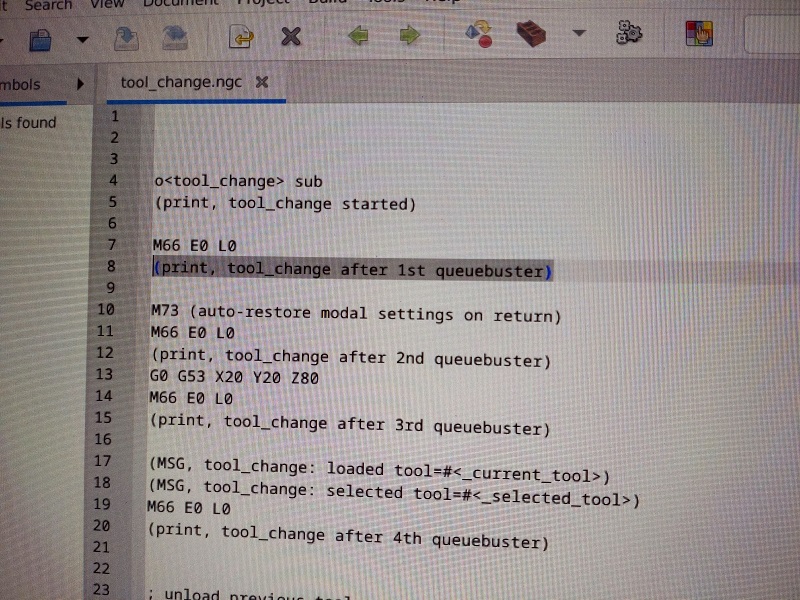

In the tool_change.ngc I added following lines so that the beginning was this:
The result is that in the terminal only the first message is posted. Meaning that it did not get past that queuebuster line. What was expected behavior there? I do not have anything connected to motion.analog-in-00 so I would expect it to read value "zero" and move on...
o<tool_change> sub
(print, tool_change started)
M66 E0 L0
(print, tool_change after 1st queuebuster)
M73 (auto-restore modal settings on return)
M66 E0 L0
(print, tool_change after 2nd queuebuster)
G0 G53 X20 Y20 Z80
M66 E0 L0
(print, tool_change after 3rd queuebuster)
(MSG, Tool change: loaded tool=#<_current_tool> )
(MSG, Tool change: selected tool=#<_selected_tool> )
M66 E0 L0
(print, tool_change after 4th queuebuster)The result is that in the terminal only the first message is posted. Meaning that it did not get past that queuebuster line. What was expected behavior there? I do not have anything connected to motion.analog-in-00 so I would expect it to read value "zero" and move on...

'tool_change started' was printed when the read-ahead ingested that line and then it stopped reading due to the queuebuster and waited for code execution to catch up. What this means is that the actual code execution does not reach the 'tool_change' subroutine.
Not sure what's going on but whatever it is it does not seem to be a problem in 'tool_change.ngc'.
