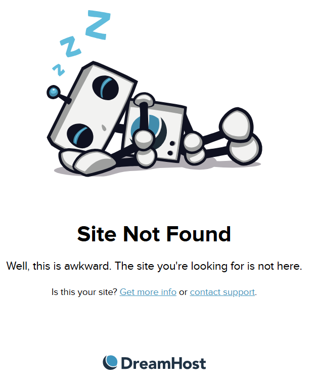

1 year 7 months ago #325492 by HalaszAttila
As I saw, all the download links on the "Contributed Components" page are not working.
1 year 6 months ago - 1 year 6 months ago #325500 by Aciera
There is a problem with https certificates try the http site:
wiki.linuxcnc.org/cgi-bin/wiki.pl?ContributedComponents
Note though that this page has not been updated for years, like most pages on the wiki.
Last edit: 1 year 6 months ago by Aciera.
1 year 6 months ago #325555 by andypugh
This isn't a great solution, but I don't have the access to fix the Dreamhost certificate.
But, you can copy the download link, then paste it into the address bar of a new window, delete the "s" in "https://..." and then it should download the file.
