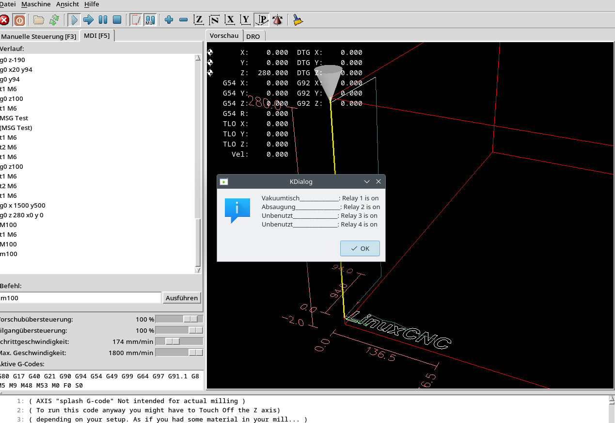

I was looking for a way to control my vacuum table's vacuum pump from within axis. After reading the manual, searching linuxcnc's forums, I realised others were probably struggling with similar tasks (myst, dust extraction, ...), too. I could not find a proof cooked recipe. Below, you'll find what I am ready to go with. It is a proof of concept at the time. However, and since I use same/similar components the same/similar way in home automation, I am positive, it works in the real harsh world. Teaser wanted?
The KDialog message box is being called by M100, this reads the relays statii and displays as shown

So we can set relays from command line, as user "user" (cnc in my case) and read their status. Howto do it from within g-code?
M1xx comes handy:
Place a script similar to attached M100 into the directory specified in the .ini file's [DISPLAY] section under PROGRAM_PREFIX = /home/cnc/linuxcnc/configs/cnc0/macros
My path above needs to be changed to your definition.
Maybe, there is some rebooting and logging in/out/in required. I did not make notes on this.

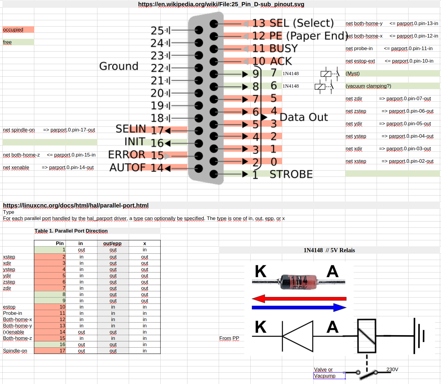

my parport pin usage:
So, it turns out langdons was right about some pins still being unused. I my case, pins 1, 8, 9 and 16 wait to be used. Hope I got the connection diagram of said 1N4148 diode and relays right, (I lack electronics knowledge). I am about to order this board:
www.conrad.com/en/p/tru-components-tc-99...-1-pc-s-2481804.html
I have a feeling, it has some sort of protection built in. The manual is not clear on this however. Anyway, some 1N4148 never seem to be unnecessary, so I order these:
www.conrad.com/en/p/tru-components-ultra...-150-ma-1581846.html
Are these OK?
