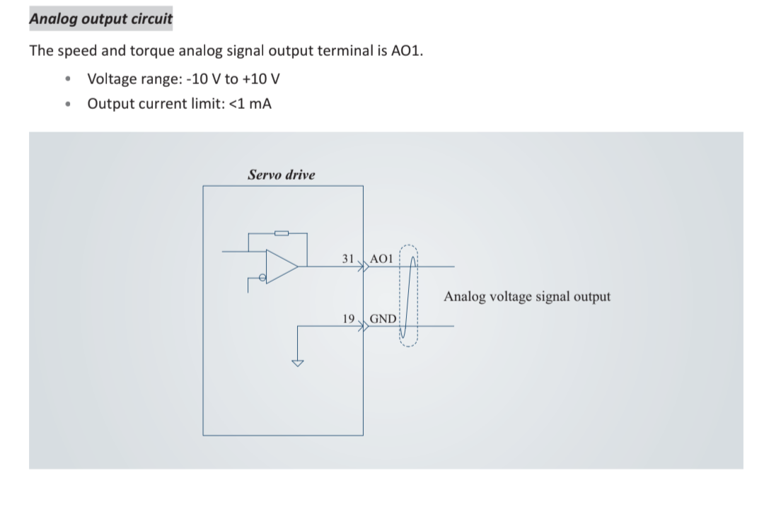

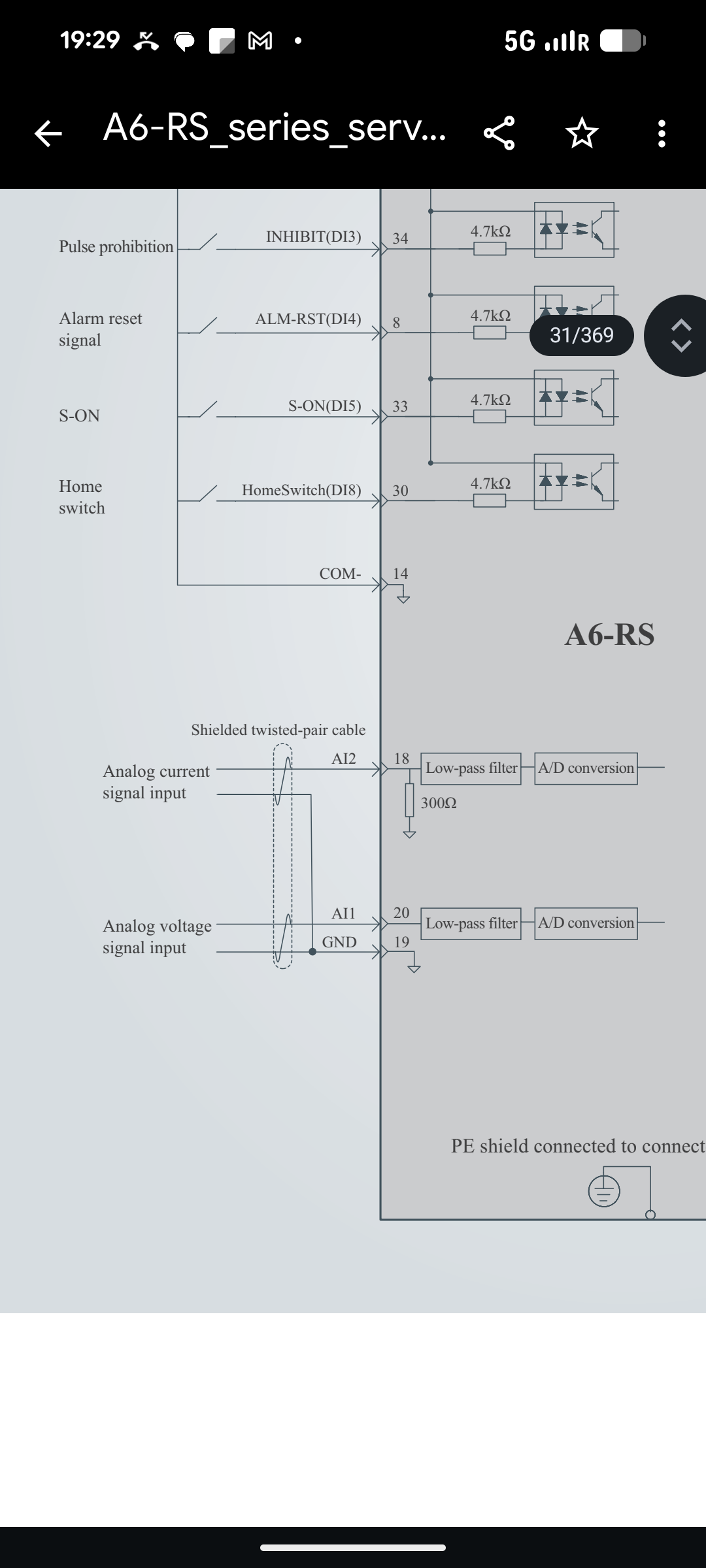

I've been using the 7i96s potentiometer function to control a DC driver board on my mill,
I'm replacing that motor with a Chinese servo that requires a 0-10v signal to be driven in speed mode,
The drive itself does not have a +10v that I can feed the digital pot on the Mesa card
Would I require a separate 10v power supply to feed the Mesa card digital pot to output the proper signal for the servo drive?
Attached are the wiring diagrams form the servo drive, and the link to the servo kit:
www.omc-stepperonline.com/fr/kit-de-serv...p67-a6-rs750h2a1-m17

Yes. you need a separate supply.
You can often use a 12V supply and scale the PWM so that full RPM = 10V
