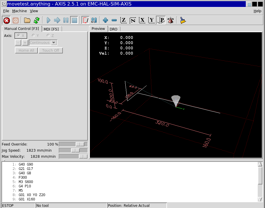

06 Dec 2012 18:08 #27293 by ArcEye
Replied by ArcEye on topic File will not run in EMC
HI
There could be a variety of reasons the file will not open, none of them to do with the extension
This screen shot shows that you can open a g code file with literally .anything as the extension, so long as you have permissions to open it and the file is a valid format for Linuxcnc
Putting PROGRAM_EXTENSION = .nc in the right part of the INI file should do the trick.
Seemed logical but in fact doing that threw an error in Axis at startup
File "/usr/bin/axis", line 2776, in <module>
extensions = tuple([(v, tuple(k.split(","))) for k, v in extensions])
ValueError: need more than 1 value to unpack
If the file has the extension .nc, where did you get it? What machine is it intended for?
You probably need to look at the contents of it and that the permissions are at least set to 744 (read/write/exec by owner, read by group/others)
regards

06 Dec 2012 19:00 #27298 by ArcEye
It seems there is a bit more to it than that. But not a lot more.
linuxcnc.org/hardy/dapper/index.php/foru...t=6&lang=french#6338
Finally tracked it down
PROGRAM_EXTENSION = .nc , .NC
produces the required result, the file appears in the file open dialog and will load
If you just put
Axis throws the error I pasted previously
Weird but can't be bothered to look much further, as selecting 'All Files' in the file open dialog would have enabled you to load the .nc file anyway
regards
