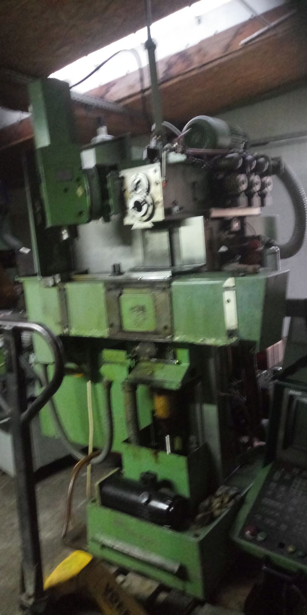

Unfortunately, I did not read the whole thread and did not read about the difficulties in obtaining a schematic.
I'm Polish.
I bought my maho MH400E machine with documentation, which I attach in full, unfortunately from another machine and I attach its photo.
So I am looking for a schematic for this model.
Sorry if I was misunderstood.
Regards
Martin
I'm Polish.
Regards
Martin
