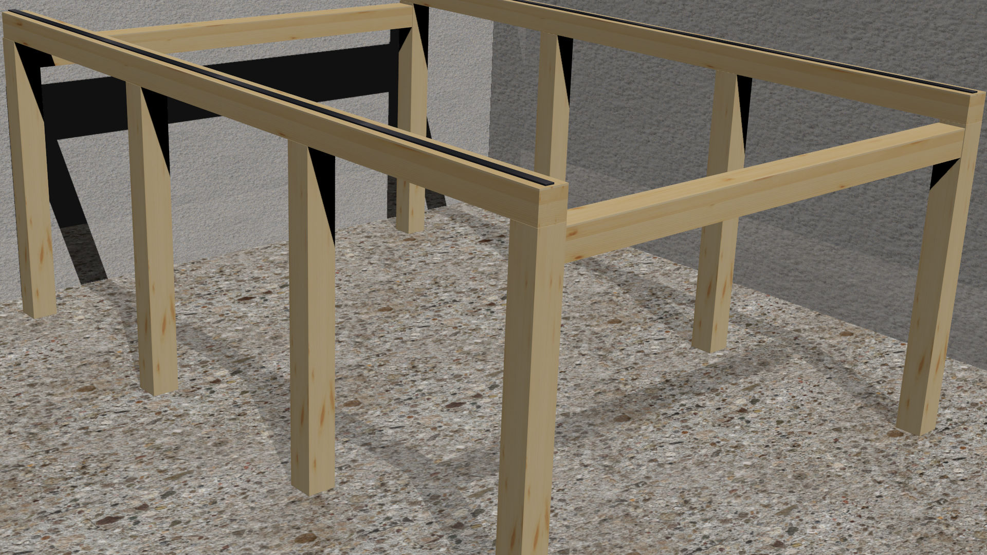

Hi
i started to build a coustom new Giant
as of Permission to the Friend i will post the projekt to be here
First image of CAD
the system is to be planed below 10k Euros
it will stand of MESA 7i92 and 2x7i76
the Motors are sugested 12Nm closed loop
the powerconsept is to be at 6000W max
there will be a flange 2" tube welded at both ends across so the stability will increase
Rail system is at HGH30
Ballscrew sfu2510 as of the size fixed on place no Rack pinion and no real top speed needed <5m/min
Square tubing is at 100mm/4" 5mm thick so haevy structuer
Some sugestions
First image of CAD
Some sugestions

Replied by tommylight on topic New Giant 5-8 joints 3x2x1meter Overhead Gantry
Fill the tubes with concreete or epoxy and sand, otherwise the noise from the vibrations will be unbearable.

Replied by pl7i92 on topic New Giant 5-8 joints 3x2x1meter Overhead Gantry
good idee
indeed thats what we en tented the weight to the ground may be a small issue
its not clear if the structure will be iron
its a discussion to go on construction wood and get only light parts to the system

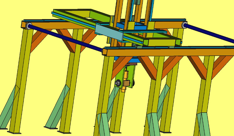

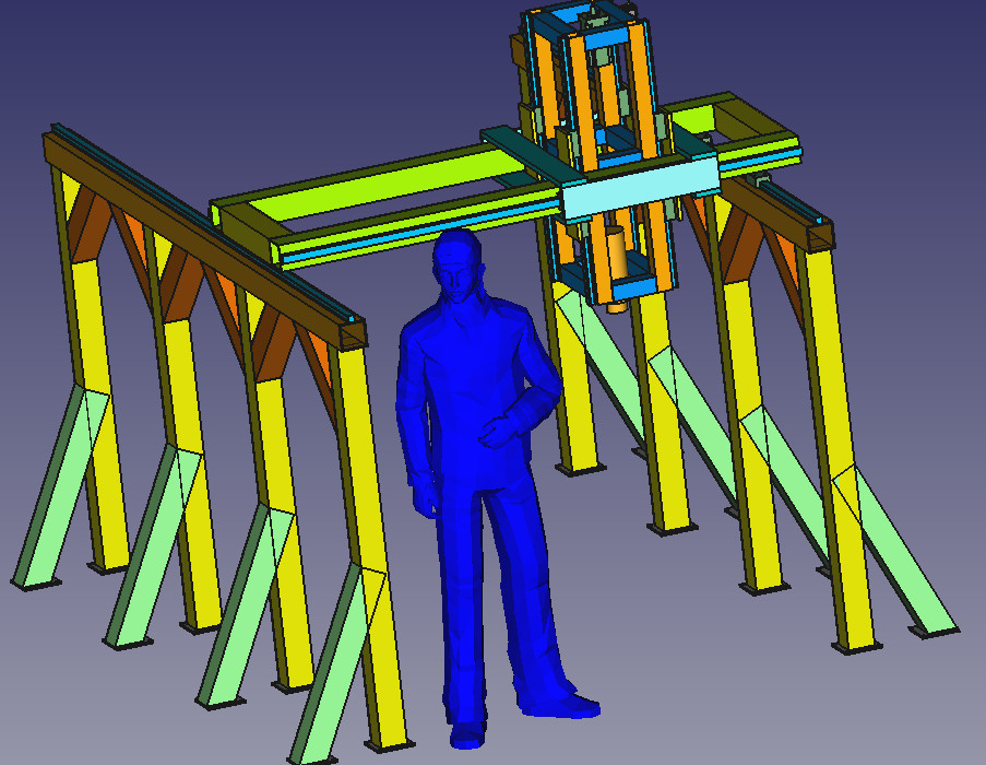

Replied by andypugh on topic New Giant 5-8 joints 3x2x1meter Overhead Gantry
I would be tempted to make the cross braces full-height and have the buttresses reach all the way to the rails.
But that would mean a lot more material, probably for little gain.
Have you seen this gantry? It's just like a hobby design, but a lot bigger:

Hi pl7i91
I fear this construction will shake a lot. You have to stiffen it with diagonal truss.

17 Aug 2019 15:20 #142390
by pl7i92
agree there will be alot of more things to get side stiffnes trust me
its a start to calculate material
i only need one side open that is the main problem to get the parts in
with a forklift
maybe a rail system at the bottom and then get it in from there
we will see how it comes
the WOOD is very cheep so no pricing on that
