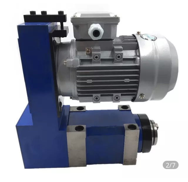

I want to buy BT-30 power head from this link
www.aliexpress.com/item/32819388833.html....44f03c00OezPmD&mp=1
I want to make sure that I buy the matching tool holder and collets for it.
I have no ATC. I will manually replace the tools, It is confusing because there are so many types of tool holders
I think this is the correct one
www.aliexpress.com/item/33018987707.html....44f03c00OezPmD&mp=1
and the collet set there are numbering like ER16-1 and ER16-2  I want ER16 but not sure what is the differance between -1 and -2
www.aliexpress.com/item/32955469867.html....44f03c00OezPmD&mp=1
I will place the order as soon as you kindly direct me if the items in the links match

The collet holders in the link are the correct ones for that spindle you have chosen.
With the BT30 spindle you are choosing BT30 collet holders for either/or ER16 or ER20 collets.
The ER16 & ER20 collets are just differant sizes, thats all.
ER20 being the larger of the two, and therefor has a greater range.
ER collets can go upto ER32 and then ER40.
The number -1 etc is the size of the bore through the collet which is used to grip the tool.
Example:
You have a cutter with a 06mm shank, and a ER20 holder, then you need:
ER20-6 collet, and so on.
However,what I don't see there are specific details of the draw bar that holds the holders in the spindle. This is important because you will need the correct corresponding 'pullstuds'.
You may need to contact the supplier for this information.
There is a note in the table: M12x45
This could be the type of pullstud required being: M12x45Degree, but make sure that it is. This type is a power type pullstud, not manual.

this spindle seems suitable for my application (for a beginner I intend to use max 8 mm bits for mild steel)
www.aliexpress.com/item/32837147837.html....2bb13c00fOi74j&mp=1
It has angular contact bearing
the chuck is integrated to the shaft or fitted in some manner. The issue I am having is that most bt-30 specs do not mention what type of pull-stud or draw-bar. I have no clue if the tool holder is power fit or manually fit.
I do not have provision to fit the tool holder pneumatically and I do not know what is required to do that ( if it is just compressed air or what?)
Just by looking it is not possible to know if it is power fitting or mechanical fitting the tool holder to the spindle.
Philip

I think that the integrated spindle has the motor pointing the wrong way.
There are other _far_ more expensive spindles for BT30.
(example: www.ebay.co.uk/itm/154031894469?epid=250...5:g:svsAAOSw3MNfJ8tf )
The difference being that those include the pneumatic drawbar and pull-stud gripper. I really don't think that the one you linked has a pull-stud gripper, I suspect that it has an M12 drawbar.
It is possible to make these things. I have.

I think that a BT30 spindle is a better choice than an integrated ER20 as BT allows you to set tool lengths, making tool-changes mid-programme much easier.
With an integrated ER collet you need to re-set the tool length on every tool change.
BT is also better for face mills / fly cutters etc as it has positive drive-dogs.
