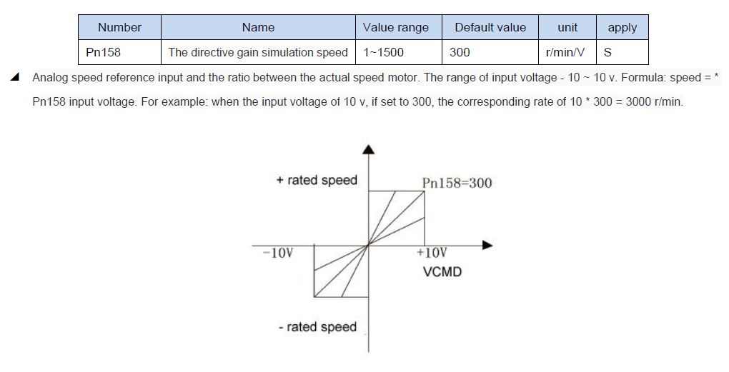

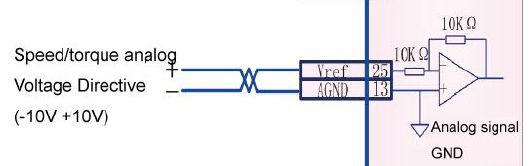

I am retrofitting a Bridgeport Series II knee mill with a Chinese AC servo and drive 'kit'. I would like to rigid tap and use spindle orient for probing operations. I'd like to keep control entirely within LinuxCNC and control the drive in velocity mode. My mill has a 7i77 with spare encoder inputs and differential outputs and ideally I'd like to control the spindle the same as the other axes on the mill, with a differential +/-10V signal.
The manual lists two pins for the 'analog voltage input port' and states 'voltage input range -10V~+10V'. This is a picture of the inputs in the manual.
https://drive.google.com/uc?id=1GViEE9WZwYFsdYNB80LrunosXCbfN517

Replied by tommylight on topic Chinese AASD Drive for Spindle Motor
What is the question?
Yes those are the pins to wire the analog out from the Mesa.
