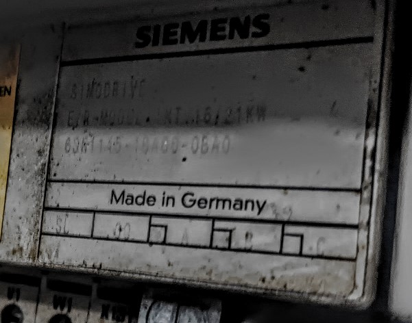

now i took a very bad picture of the SIMODRIVE 611 name plate... but for the life of me, i cant see what the model of the drive is..
please if anyone can see, let me know..
i'll update this as time goes on.. but i'm gonna need to start thinking about what masa cards i need to order... and get on with it...
thanks for any help, ahead of time..

18 Jul 2022 10:40 #247650
Replied by tommylight on topic Bridgeport VMC1000 refit
KT16/21KW
I use reading glasess...

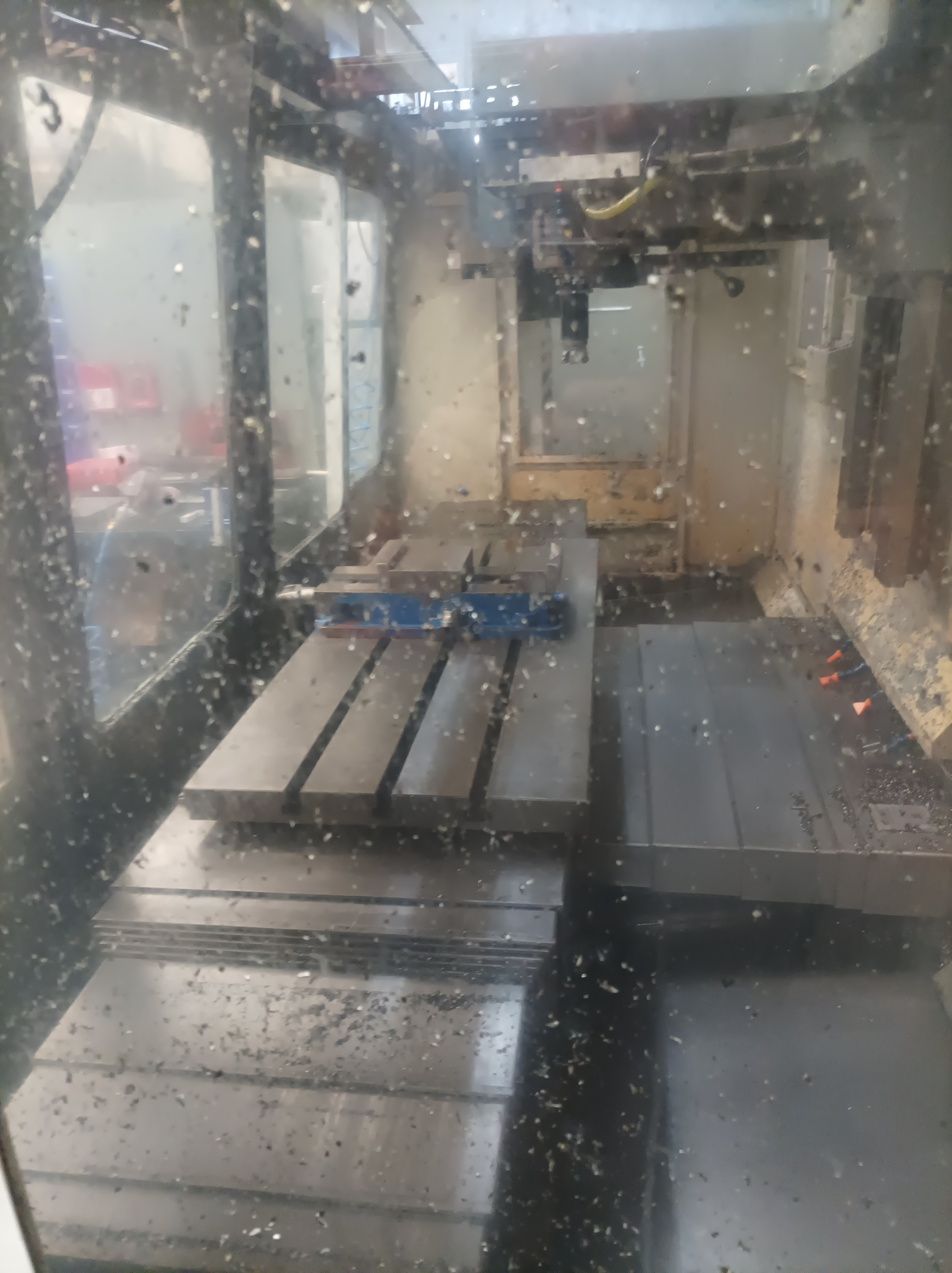

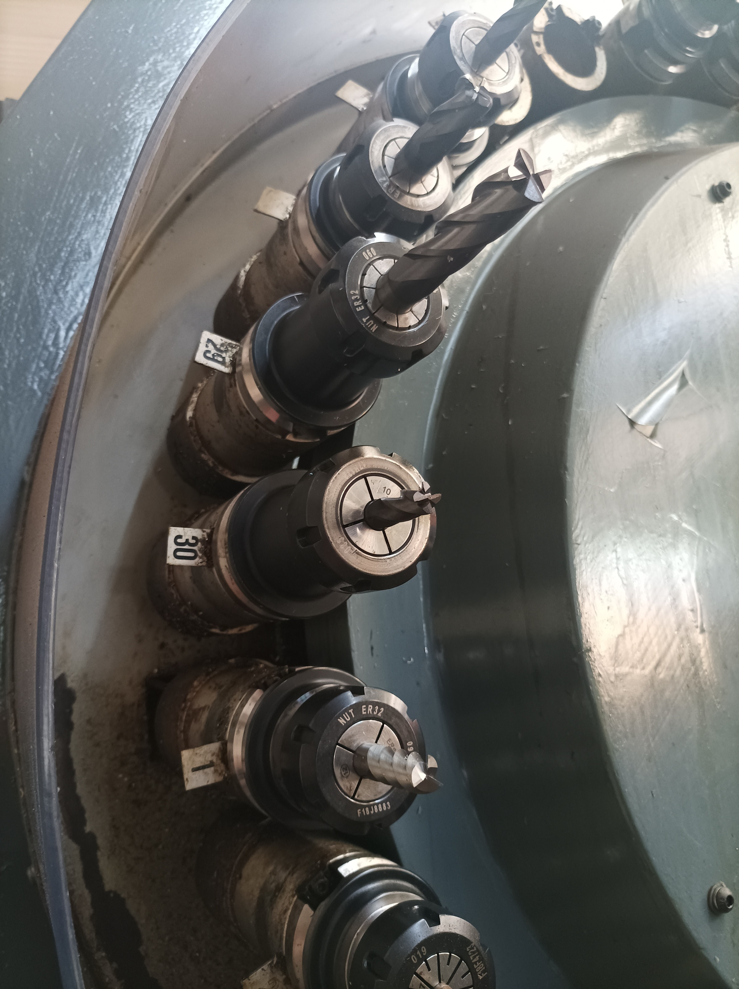

So I popped into the workshop today, And took a load of pictures.... Just for amusement here are a few.... And maybe that simodrive model number is a bit clearer...
Anyway.... I'm off 2 hunt down manuals
Wish me luck
Pb

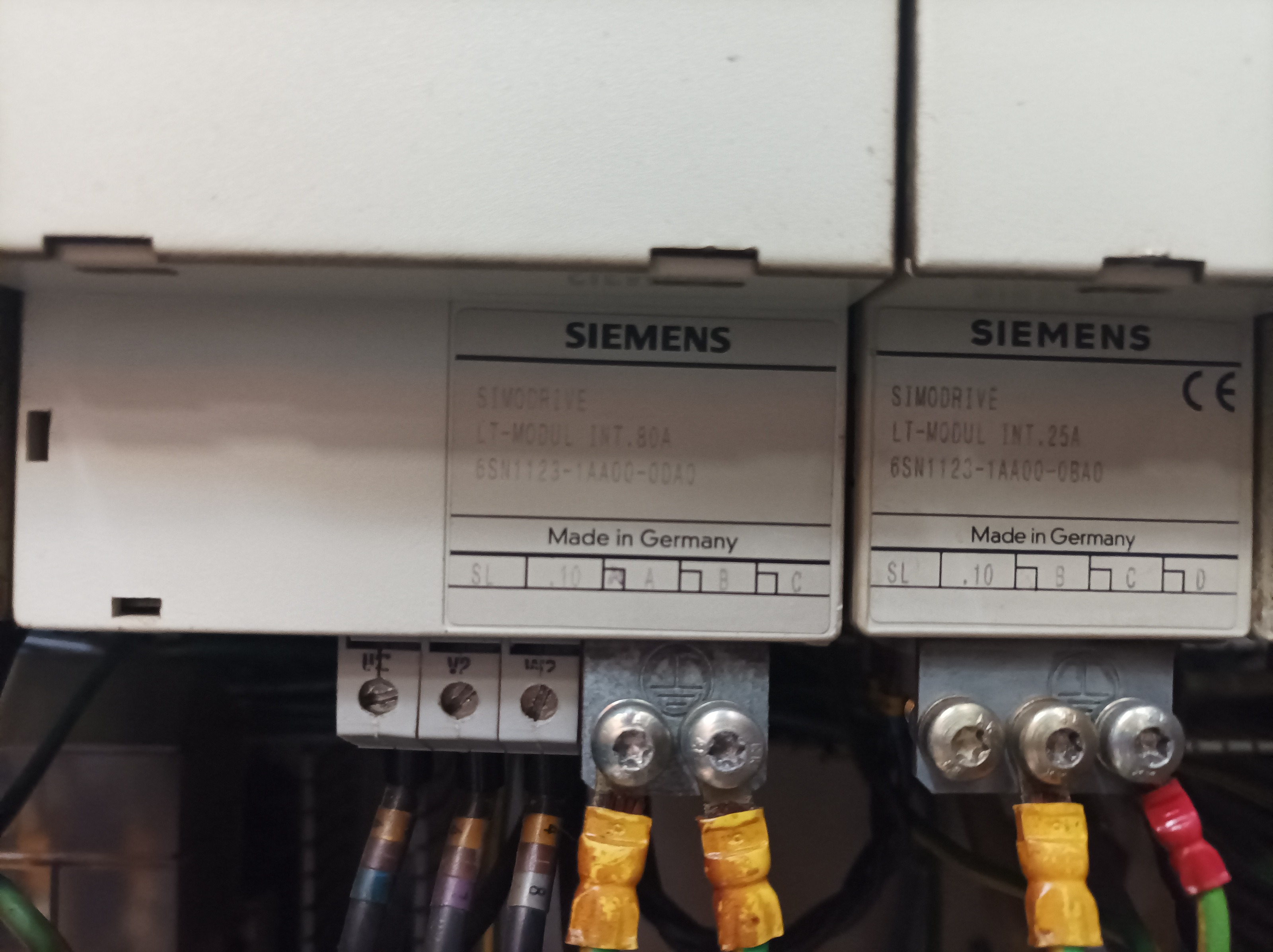

my last post might make it look like i've not really been trying... but trust me I've been looking...
now the original wiring is still in place... and here is a picture...
and in this picture you can see the various ports, and connections.. and i've been trying to understand what i'm looking at, just as much as finding the pinouts for making the connection for a mesa card...
so maybe if you know the missing info., please feel free to enlighten me..
thanks

19 Jul 2022 15:00 #247769
Those are the drives, for sure, not sure what the big box on the left is, but i would say you are looking at the wrong part.
Follow the encoders, those shoukl go to the controller, usually where the pc and monitor are, that is where the work sbould be done.
Almost always the drives remain untouched, everything connected to drives remains as is.

- arvidb
- Posts: 459
- Thank you received: 158
19 Jul 2022 16:05 #247773
by arvidb
Replied by arvidb on topic Bridgeport VMC1000 refit
Looking around a bit with no prior knowledge, 6SN1145 is an "infeed module" (that produces the DC bus for the power modules?). 6SN1123 are the "power modules" (motor drives?). The type of control input is decided by the control card in each power module, in this case 6SN1118-0AA11-0AA1.
Searching for this on Siemens' web page finds a bunch of manuals, but they all seem to cover a newer and only partially compatible control board: link .
